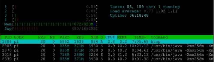

But it was actually pretty slow since the Swap memory of a Raspberry Pi is slow. So I "installed" Zram which compresses the RAM files. Then, Share got a lot more fluent. It is just slow starting up, especially when logging the admin user, but it is pretty fine after that.
So for two normal (not admin) users at the same time (I can't test it on a bigger scale for the moment) it works pretty fine, the Raspberry Pi isn't blowing up and so on so if you want to do something like this enjoy it !
In term of perf here is a screenshot of my system after two admin logged, as you can see it is ok even though I'm trying to know if I can improve the management of the memory.
