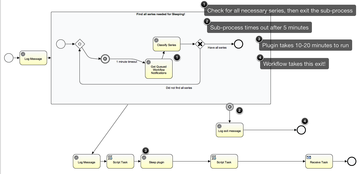

Please see the attached diagram.
I have a workflow that uses a subprocess. The subprocess waits for a set of series to arrive (labeled #1, see the associated question), when everything is ready, the workflow should proceed to the plugin (a JavaDelegate, labeled #3). But the plugin takes longer than the sub-process timeout (labeled #2) and the workflow exits (labeled #4) through the timeout branch, not the "plugin" branch.
If the "plugin" is async, all works well, but if not, the sub-process timeout fires and the workflow exits unexpectedly. I would not have expected this behavior.
Should Activiti detect that the execution has left the sub-process and cancel the timeout?
Thanks,
-dan
