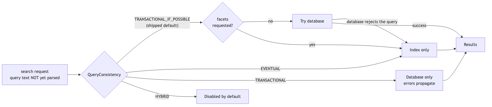

What actually picks the engine
query.fts.queryConsistency picks the engine, and the query string plays no part in it. The AFTS text is not parsed until after an engine has already been chosen, so nothing you write in the query can influence the routing decision. There are four behaviours:
EVENTUAL - index only, never the database.
TRANSACTIONAL - database only. Failures propagate to the caller rather than being retried.
TRANSACTIONAL_IF_POSSIBLE and DEFAULT - try the database, fall back to the index. This is the shipped default for the elasticsearch subsystem, set in its elasticsearch.properties.
HYBRID - disabled by default, and Solr-only in practice.
There is a second exclusion that is less well known: if a request asks for facets, the database is skipped entirely, no matter what the query contains. This is the single most common reason a query that used to run in the database quietly moves to the index.
The routing wiring is subsystem-agnostic, and more so than you might expect. It is defined once and inherited by all five search subsystems: solr, solr4, solr6, elasticsearch and even noindex. The elasticsearch and solr6 definitions differ only in the subsystem name and the index-side component, and both default to TRANSACTIONAL_IF_POSSIBLE. Switching search engines changes none of this.
Figure 1: how the engine is chosen. The query string plays no part in it.

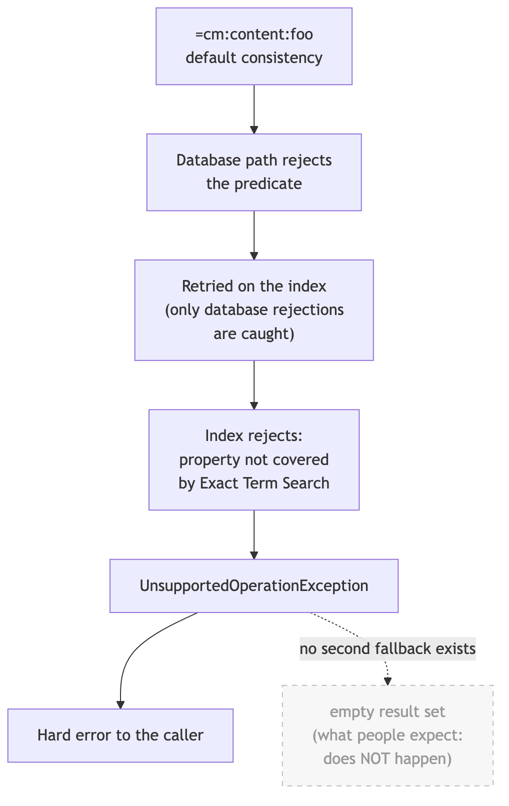

The trap
This is the part to put on a migration checklist.
If a query using = reaches the index and touches a property that Exact Term Search does not cover, you do not get a fallback and you do not get an empty result set. You get a hard error: UnsupportedOperationException("Exact term search is not supported for property: <name>").
The reason there is no recovery is that the switching layer catches only QueryModelException. An UnsupportedOperationException is unrelated to that type, so it passes straight through, and the index side re-throws it deliberately ahead of its generic handlers so that it escapes un-wrapped.
Traced through the REST layer, nothing registers a resolver for this exception type and the catch-all maps it to an internal server error, so it should surface as an HTTP 500 rather than a 4xx. That is strongly implied by the code path rather than measured, so treat the status code accordingly.
Figure 2: the trap. The dashed branch is what people expect and does not exist.
Two aggravating factors.
One uncovered property fails the whole query, including inside an OR. With only d:text and d:mltext covered, cm:name:run OR cm:persondescription:run returns results while =cm:name:run OR =cm:persondescription:run throws, because cm:persondescription is d:content. There is no partial evaluation.
=TEXT: and =ALL: expand, and every expanded field must be covered. TEXT: fans out to four default fields - cm:name, cm:title, cm:description and cm:content - and ALL: fans out over every property in the dictionary. Both propagate the exactness flag into the per-field check, so =ALL: throws on the first unconfigured property it meets.
This one is worth being careful about, because =TEXT: looks like it works once you enable the d:text and d:mltext datatypes. It does not. Of the four default fields, cm:name is d:text and cm:title and cm:description are d:mltext, but cm:content is d:content and needs its own entry:
alfresco.cross.locale.property.0={http://www.alfresco.org/model/content/1.0}content
Remove that one line and =TEXT: throws.
