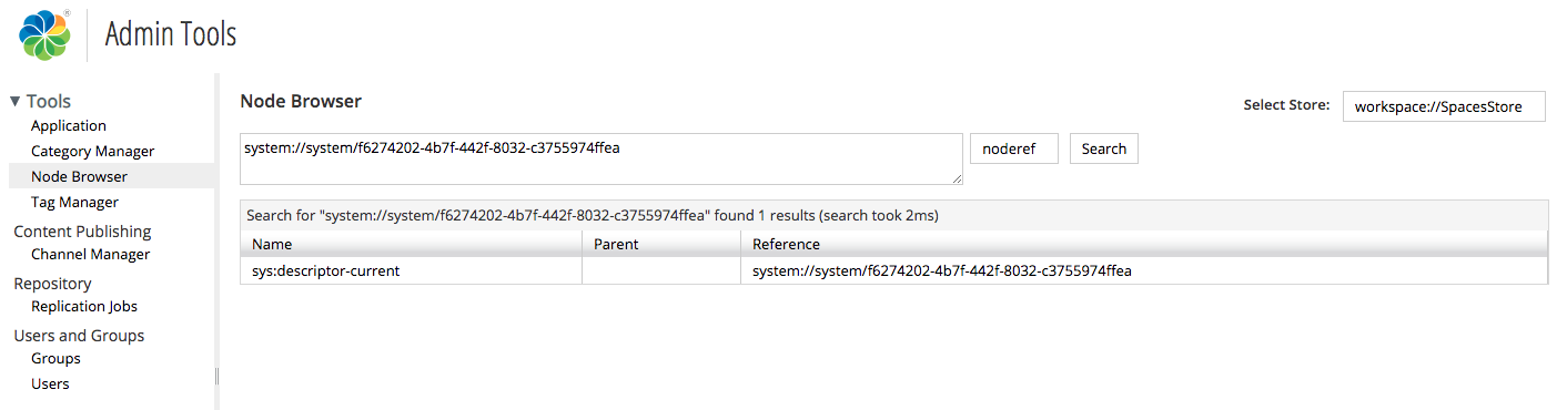

To have a better context of the nature of those binary files, you can find the descriptor node in Alfresco using the nodebrowser. In this case, the noderef will be:
system://system/f6274202-4b7f-442f-8032-c3755974ffea
The following screenshot shows how to search the descriptor node using the nodebrowser:

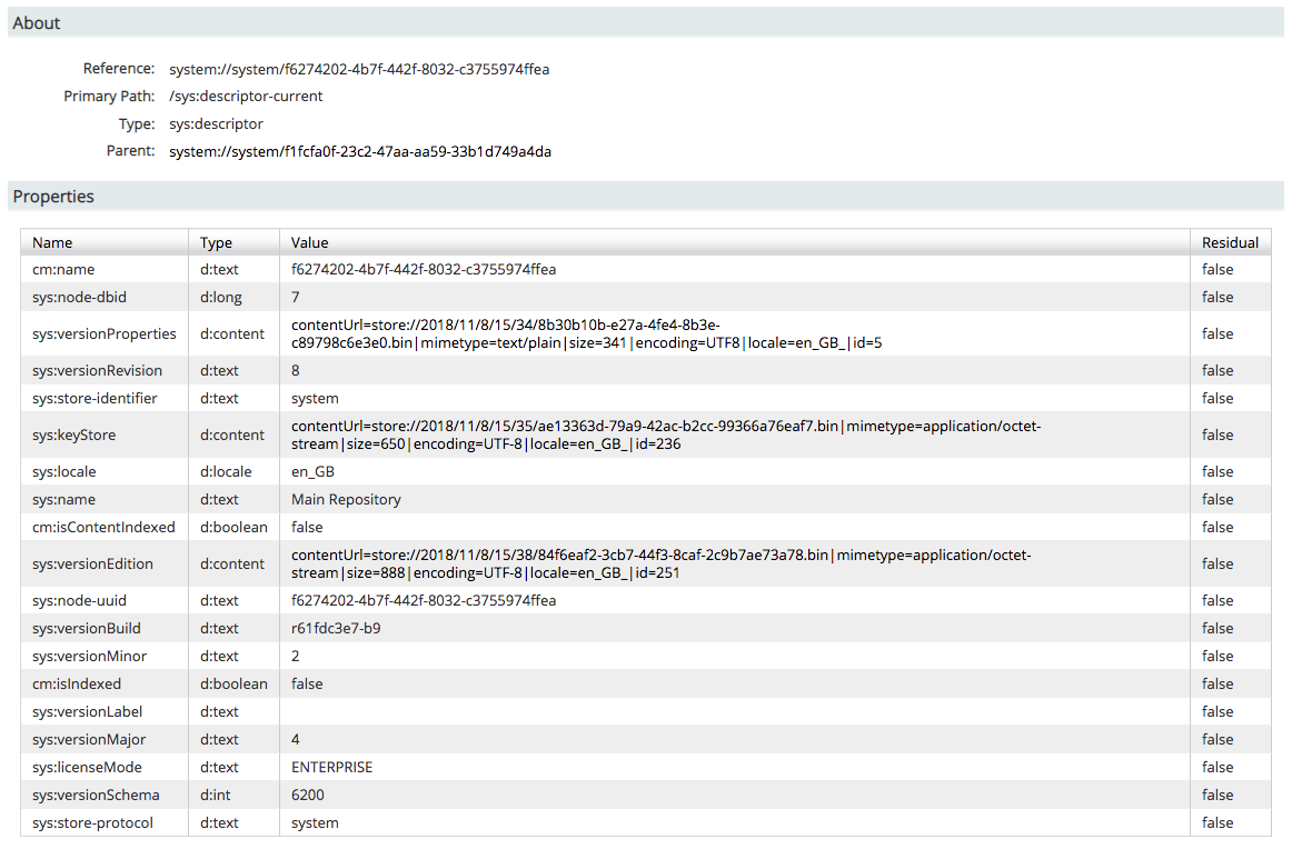

This screenshot shows all the properties for the descriptor node:
Notice that the descriptor node has the following properties associated with the binary files found with the SQL query:

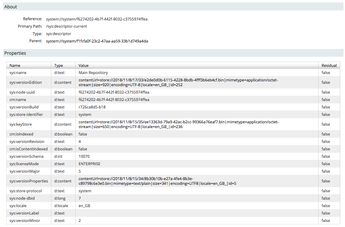

Once the new instance with Alfresco 5.2.4 is ready with the requirements of step 2, we just need to bootstrap it. Alfresco will upgrade the database and will create new files on the content store. No warnings regarding missing files will be seen in the logs.
Moreover, when upgrading from Alfresco 4.2.x version to 5.2.x, new configuration files such as user dashboards will be created, therefore we will be able to log in into share with admin user with no issues.
The descriptor node will be updated with the new Alfresco version (5.2.4) and two new binaries linked to this node will be created as shown in the following screenshot:
