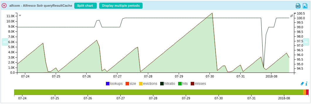

In the summary page Solr exposes data regarding caches. We know caches are very important for Solr to perform well. Undersize your caches and your search will be slow like an old dog. Oversize them and you may end up consuming way more expensive memory than you actually need.
Cache sizes are used in the overall memory requirement calculation for Solr. See Alfresco documentation bellow:Calculate the memory needed for Solr nodes | Alfresco Documentation
The plugin will report data on cache usage such as:
- number of lookups (incremental counter rested periodically)
- cache size (number of item in the cache)
- evictions (accumulated evictions from the cache since server startup)
- hitratio (accumulated ratio of hits vs misses)
The plugin will return warning or critical alerts based on thresholds passed as arguments. Those thresholds are applied on the hitratio only. It means you can track and graph those metrics but only hitratio can trigger alerts (eg an email or text message depending on the monitoring system configuration.)

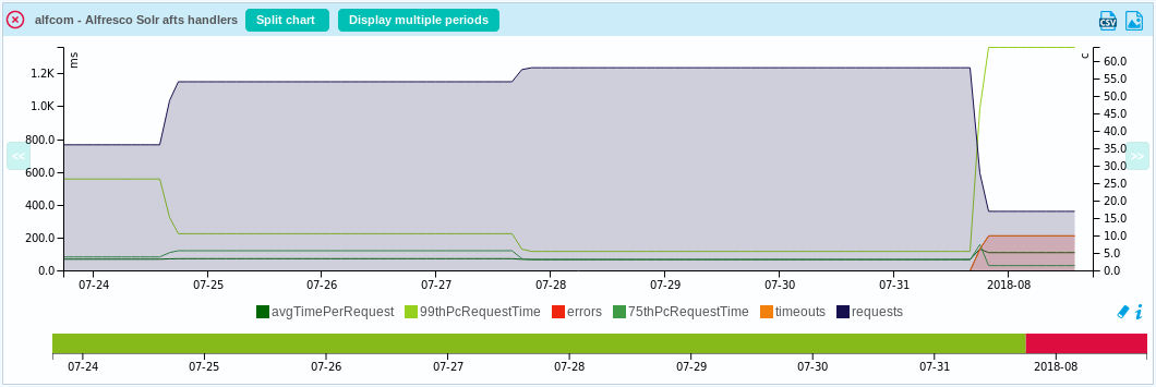

Handler data is also provided by Solr summary page. Handlers are HTTP endpoints Solr uses to handle requests... hence the name. Data provided for the handlers and used by the plugin are:
- errors: number of queries which caused an error (500 http status code)
- timeouts: number of queries which could not ne fullfilled before timeout
- requests: overall number of requests
- avgTimePerRequest: Average time to fullfill a request
- 75thPcRequestTime: maximum time it takes to reply to the 75% of the fastest requests
- 99thPcRequestTime: maximum time it takes to reply to the 99% of the fastest requests
Request time data are typically useful in order to track how the search service evolves and anticipate when scaling is needed or if something is running abnormally (e.g. slower disk access, or network latency). avgTimePerRequest is used to trigger alerts while percentile request times are only used for performance data.
A handler returning an error count higher than zero will always trigger a critical alert, and one returning a timeout will always trigger a warning alert.
While they are not really a problem (from an operation point of view), syntaxically incorrect searches will increment the error counter and thus generate critical alerts. It can be useful to have such alerts to track improper use of the API or suspicious behaviours. However having alerts for this kind of events may not be appropriate in some environments so this can be changed using a command line option (`--relaxed`), in which case only time based alerts will be triggered using the threshold provided as parameters.

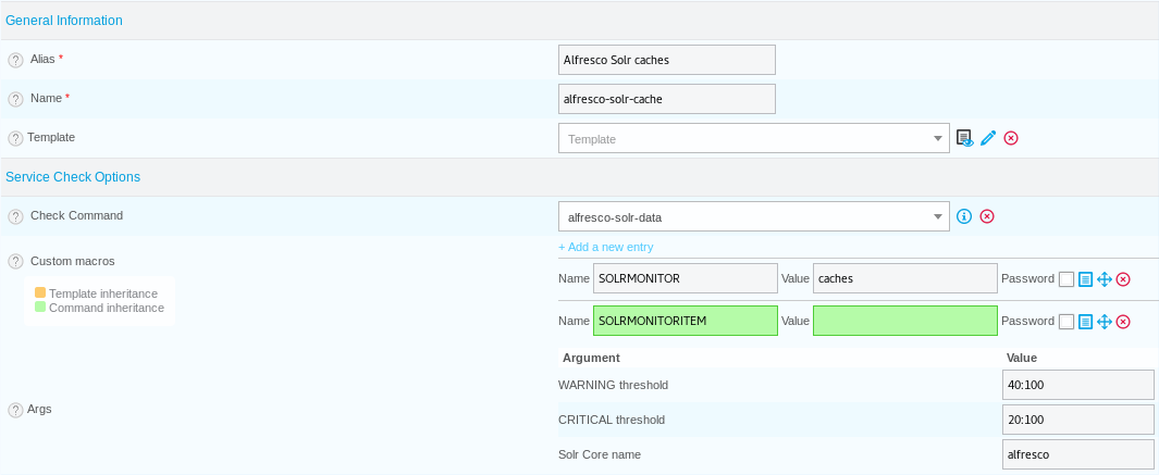

Check commands

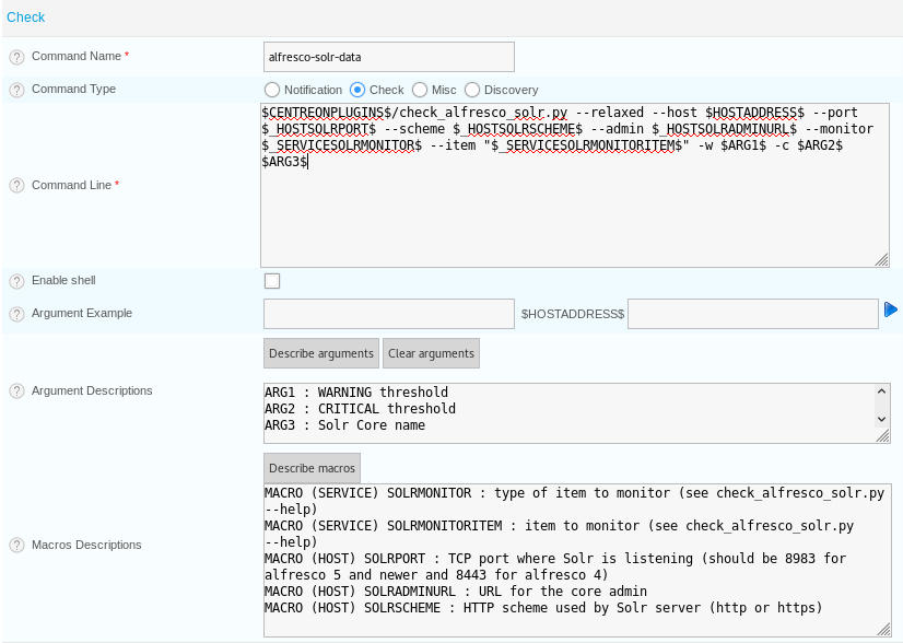

With Nagios like system it all begins with a new command to add to the system. When deploying the plugin we've copied it to the Nagios plugin directory (by default /usr/lib/nagios/plugins). In Centreon most configuration is done through a web interface and the plugin directory is referred to as $CENTREONPLUGINS$. On Nagios similar configuration applies but editing configuration files has to be done through a regular text editor (all configuration files should be located in /etc/nagios).
So in the "Configuration\Commands\Checks" menu click the "Add" button to add a new command and set it as shown bellow:
the command can be explained as follow:
- --relaxed: do not trigger alerts if handlers reports errors or timeouts
- --host $HOSTADDRESS$: specify the Solr hostname (will be expanded from the Solr server configuration)
- --port $_HOSTSOLRPORT$: specify the Solr port (will be expanded from the service template)
- --scheme $_HOSTSOLRSCHEME$: specify the Solr http scheme (will be expanded from the service template)
- --admin $_HOSTSOLRADMINURL$: specify the Solr admin URL (will be expanded from the service template)
- --monitor $_SERVICESOLRMONITOR$: specify the kind of element we want to monitor (handlers or caches or index values)
- --item "$_SERVICESOLRMONITORITEM$": specify the name of the item we monitor
- -w $ARG1$: the warning threshold triggering the warning alerts (value depends on what we want to monitor
- -c $ARG2$: the critical threshold triggering the critical alerts (value depends on what we want to monitor
- $ARG3$: the name of the Solr core to monitor (will be expanded from the service template.

Each item we want monitor will be defined as a service attached to a host. In the end, we will need to attach one service per solr host, per core, per cache and/or handler, per index metrics we want to monitor.
This can lead to numerous services and can be long to configure. For this reason it is not desirable to trigger alters for every single metric we have access to. For example triggering alerts for "Alfresco Nodes in Index" doesn't make much sense while "Alfresco Error Nodes in Index" does.
Nagios provides inheritance and template features, this is also very handy to avoid duplicating configuration for each service. To be concrete, it means we can define a service using a template which inherits values from each other. For instance, in order to define a service to monitor the "/queryresultCache" cache, we can define a general template for caches (e.g. setting $SOLRMONITOR$ , solr core name together with the warning and critical thresholds), and a more specific template for the "/queryresultCache" (setting the $SOLRMONITORITEM$) which inherit from the general one.
Below I explain how to setup the Solr "/queryResultCache". For a broader monitoring you should also set more service and service templates for the needed items. See the help message of the plugin by using (or see documentation on the git repo):
$ python check_alfresco_solr.py --help
So in the admin, let's go to the "Configuration\Services\Templates" section and create a first template called "alfresco-solr-caches":
- Warning threshold is set so that a hitratio lower than 40% will trigger a warning alert
- Critical threshold is set so that a hitratio lower than 20% will trigger a critical alert

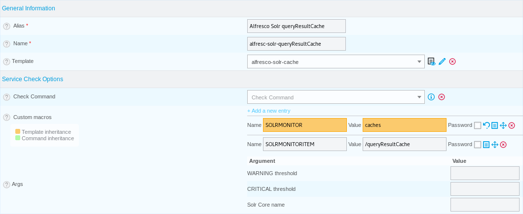

Then we create a second, more specific, template called "alfresc-solr-queryResultCache" which inherits from the general one:
Here we just set the specific cache we want to monitor. Also note the "Template" field which reference the general template. Due to the template inheritance we can leave other fields blank and inherit values.

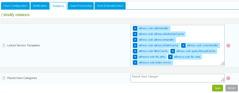

Just like we created service templates, we will create a host template. This is to avoid manually attaching the service templates we created to each individual Solr server we want to monitor.
In the Centreon admin navigate to "Configuration\Host\Template" and create a new template called "alfresco-solr" (for instance). Then go in the "Relations" tab of this host and add the service templates we defined earlier and are relevant for you:
Click Save.

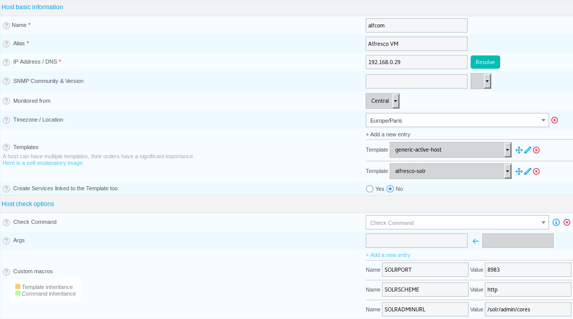

At this point we can define the host and monitoring will be ready. Either you can create a new host (if it doesn't exist already) or you can just apply the newly defined host template to an existing host.
Doing so will add Solr specific macros you will need to fill when to validate the host:

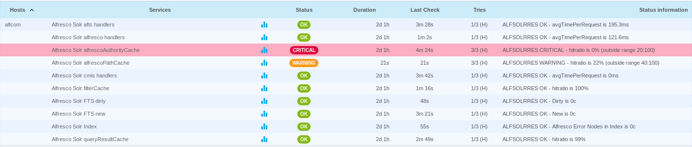

As an example bellow is the monitoring service page of a solr host:

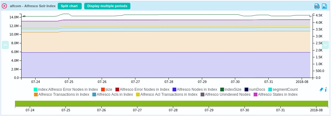

For index:

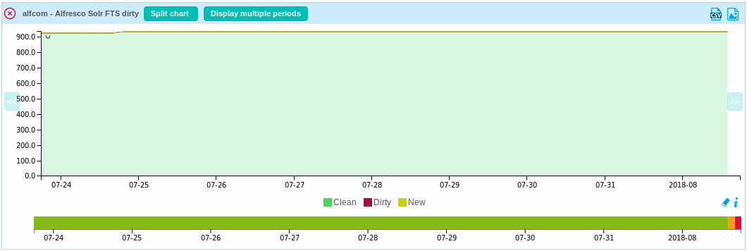

For FTS:
For a cache:
For a handler:
