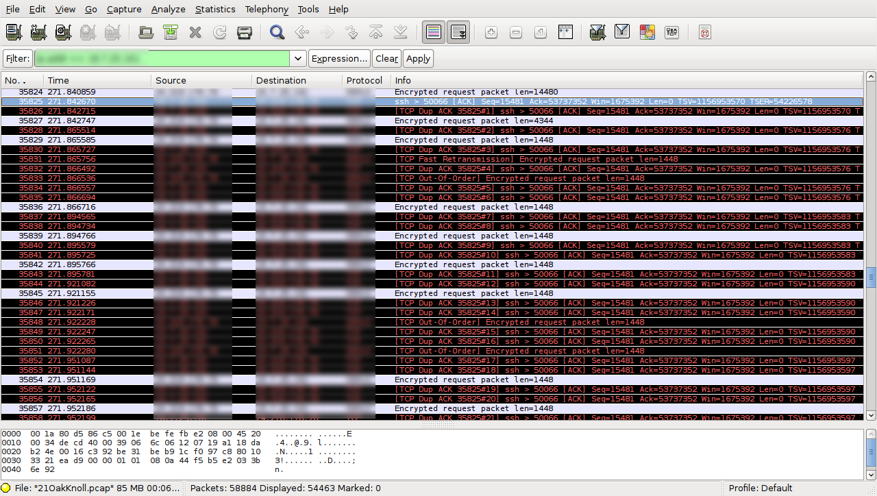

Overall network quality is also something to check. If your network devices spend their time reassembling unordered packets or retransmiting them the application performances will suffer from it. This can be checked by taking a network dump during query execution and opening it using wireshark.
In order to take the dump you can use the following tcpdump command:
alxgomz@alfresco:~$ tcpdump -ni any port 5432 and host 192.168.0.68 -w /tmp/pgsql.pcap
Opening it in wireshark should give you an idea very quickly. If you see a dump with a lot of red/black lines then it might be an issue and needs further investigations (those lines are colored this way if wireshark has the right syntaxic coloration rules applied).

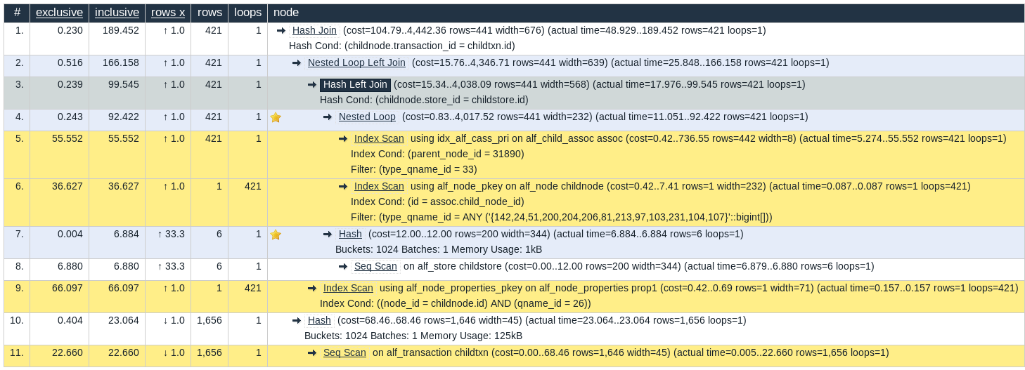

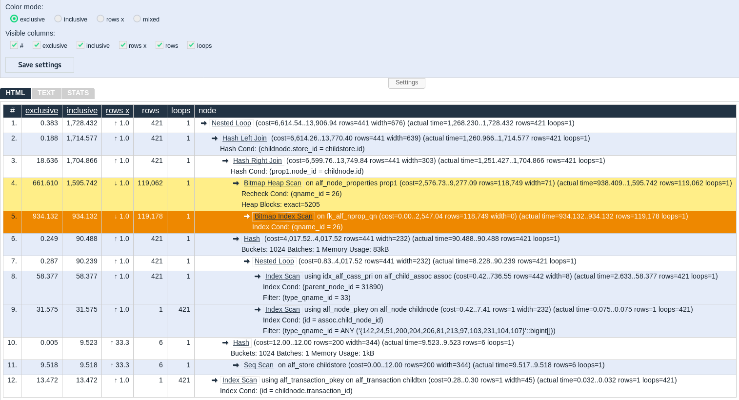

The purpose of this article is not to learn how to fully understand a query plan, so instead,we will use a very handy online tool which ill parse the output for us and point out the problems we may have: New explain | explain.depesz.com
Only by pasting the same output and submitting the form we will get a better view of what's going on and what we need to look at.
The "exclusive" color mode gives the best representation of how efficient each individual node is."Inclusive" mode is cumulative (so the top row will always be dark red as it's equal to the total execution time)."rows x" shows how accurately the query planner is able to guess the number of rows.If using "mixed" color mode, each cell in each mode's column will have its own color (which can be a little bit harder to read).
So here we can see straight away that nodes #4 & #5 are where we are spending most time. We can see that those nodes return a big amount of rows (more than 100 000 while there are only 421 of then in the final result set) meaning that the available indexes and statistics are not good enough.

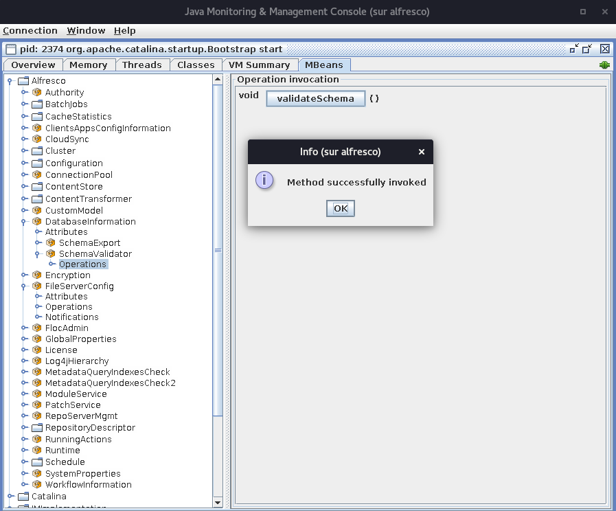

Alfresco schema validation
When connected to the JMX interface, in the MBeans tab, it is possible to trigger a schema validation while alfresco is running (go to "Alfresco \ DatabaseInformation \ SchemaValidator \ Operations" and launch "valideateSchema()").
This will produce the output bellow in the Alfresco log file:
2017-12-18 15:21:32,194 WARN [domain.schema.SchemaBootstrap] [RMI TCP Connection(6)-10.1.2.101] Schema validation found 1 potential problems, results written to: /opt/alfresco/bench/tomcat/temp/Alfresco/Alfresco-PostgreSQLDialect-Validation-alf_-4191170423343040157.txt<br> 2017-12-18 15:21:32,645 INFO [domain.schema.SchemaBootstrap] [RMI TCP Connection(6)-10.1.2.101] Compared database schema with reference schema (all OK): class path resource [alfresco/dbscripts/create/org.hibernate.dialect.PostgreSQLDialect/Schema-Reference-ACT.xml]
The log file points us to another file where we can see the details of the validation process. Here for example we can see that an index is indeed missing :
alfresco@alfresco:/opt/alfresco/bench$ cat /opt/alfresco/bench/tomcat/temp/Alfresco/Alfresco-PostgreSQLDialect-Validation-alf_-4191170423343040157.txt<br>Difference: missing index from database, expected at path: .alf_node_properties.alf_node_properties_pkey
