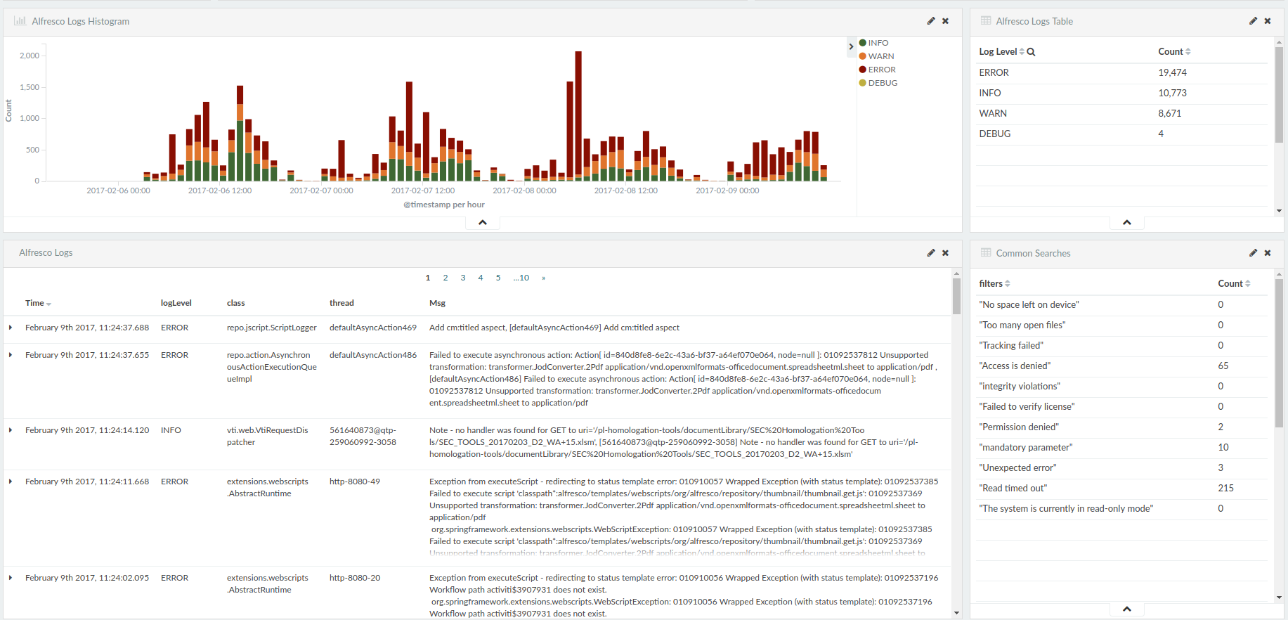

9.1 Alfresco Logs
Alfresco logs i.e. alfresco.log, share.log, solr.log or the equivalent catalina.out can be parsed to provide information such as number of errors or exceptions over a period of time. We can also search these logs for specific data.
The first thing is to make sure the logs are displaying the full date time format at the beginning of each line. This is important so we can display the entries in the correct order.
Make sure in your log4j properties files (there is more than one) the file layout pattern is as follows:
log4j.appender.File.layout.ConversionPattern=%d{yyyy-MM-dd} %d{ABSOLUTE} %-5p [%c] [%t] %m%n |
This will produce log entries with the date at the beginning of the line as this one:
2016-09-12 12:16:28,460 INFO [org.alfresco.repo.admin] [localhost-startStop-1] Connected to database PostgreSQL version 9.3.6
Important Note: If you upload catalina files then don’t upload alfresco (alfresco, share, solr) log files for the same time period since they contain the same entries and you will end up with duplicate entries in the Log Analyser tool.
Once the logs are processed the resulting data is shown:
- Number errors, warnings, debug, fatal messages, etc over time
- Total number of errors, warnings, debug, fatal messages, etc
- Common messages that may reflect issues with the application
- Number of entries grouped by java class
- Number of exceptions logged
- All log files are searchable using ES (Elasticsearch) search syntax

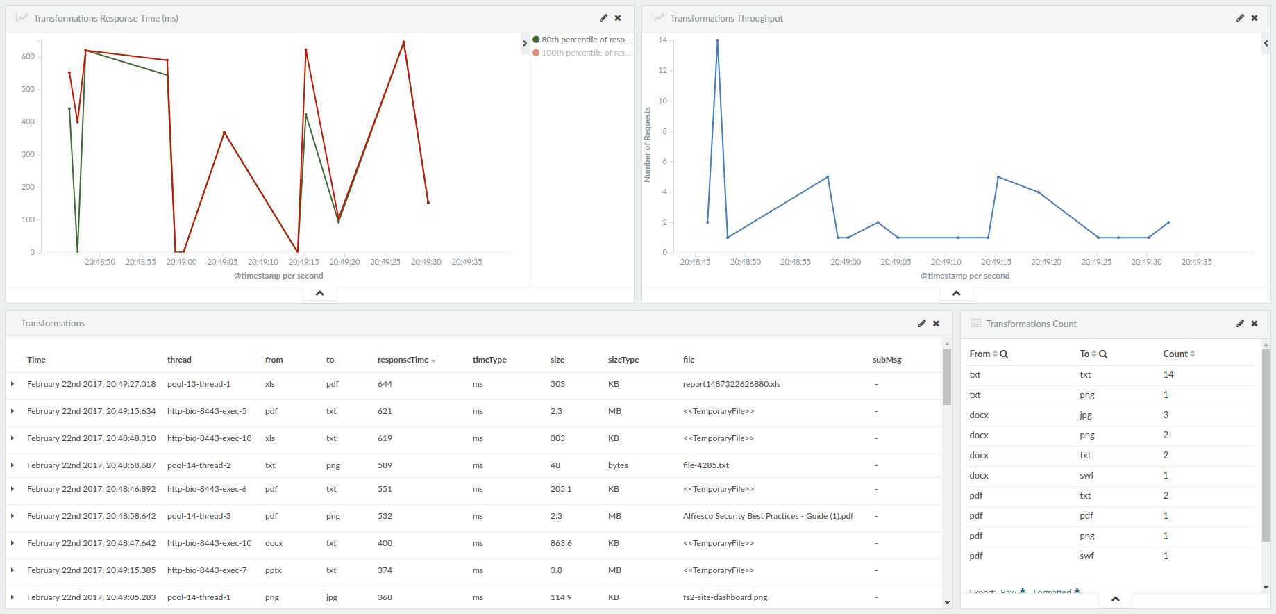

9.2 Document Transformations
Alfresco performs document transformations for document previews, thumbnails, indexing content, etc. To monitor document transformations enable logging for class “TransformerLog” by adding the following line to tomcat/shared/classes/alfresco/extension/custom-log4j.properties on all alfresco nodes:
| log4j.logger.org.alfresco.repo.content.transform.TransformerLog=debug |
The following is a sample output from alfresco.log file showing document transformation times, document extensions, transformer used, etc.
| 2016-07-14 18:24:56,003 DEBUG [content.transform.TransformerLog] [pool-14-thread-1] 0 xlsx png INFO Calculate_Memory_Solr Beta 0.2.xlsx 200.6 KB 897 ms complex.JodConverter.Image<<Complex>> |
Once Alfresco logs are processed the following data is shown for transformations:
- Response time of transformation requests over time
- Transformation throughput
- Total count of transformations grouped by file type
- Document size, transformation time, transformer used, etc

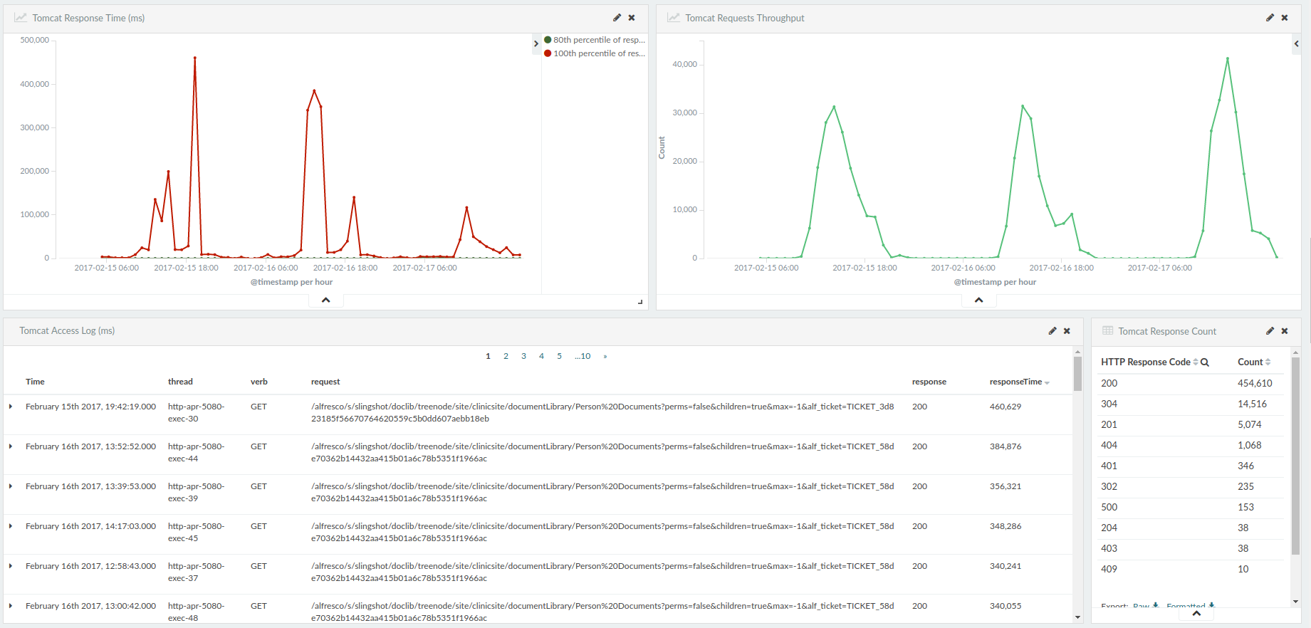

9.3 Tomcat Access Logs
Tomcat access logs can be used to monitor HTTP requests, throughput and response times. In order to get the right data format in the logs we need to add/replace the “Valve” entry in tomcat/conf/server.xml file, normally located at the end of the file, with this one below.
<Valve className="org.apache.catalina.valves.AccessLogValve" directory="logs" prefix="access-" suffix=".log" pattern='%a %l %u %t "%r" %s %b "%{Referer}i" "%{User-agent}i" %D "%I"' resolveHosts="false" /> |
For further clarification on the log pattern refer to: https://tomcat.apache.org/tomcat-7.0-doc/config/valve.html#Access_Logging
Sample output from tomcat access log under tomcat/logs directory. The important fields here are the HTTP request, the HTTP response status i.e. 200 and the time taken to process the request i.e. 33 milliseconds
| 127.0.0.1 - CN=Alfresco Repository Client, OU=Unknown, O=Alfresco Software Ltd., L=Maidenhead, ST=UK, C=GB [14/Jul/2016:18:49:45 +0100] "POST /alfresco/service/api/solr/modelsdiff HTTP/1.1" 200 37 "-" "Spring Surf via Apache HttpClient/3.1" 33 "http-bio-8443-exec-10" |
Once the Tomcat access logs are processed the following data is shown:
- Response time of HTTP requests over time
- HTTP traffic throughput
- Total count of responses grouped by HTTP response code
- Tomcat access logs files are searchable using ES (Elasticsearch) search syntax

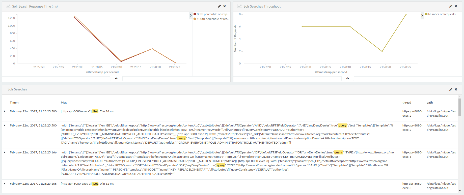

9.4 Solr Searches
We can monitor Solr queries and response times by enabling debug for class SolrQueryHTTPClient by adding the following entry to tomcat/shared/classes/alfresco/extension/custom-log4j.properties on all Alfresco (front end) nodes:
| log4j.logger.org.alfresco.repo.search.impl.solr.SolrQueryHTTPClient=debug |
Sample output from alfresco.log file showing Solr searches response times:
DEBUG [impl.solr.SolrQueryHTTPClient] [http-apr-8080-exec-6] with: {"queryConsistency":"DEFAULT","textAttributes":[],"allAttributes":[],"templates":[{"template":"%(cm:name cm:title cm:description ia:whatEvent ia:descriptionEvent lnk:title lnk:description TEXT TAG)","name":"keywords"}],"authorities":["GROUP_EVERYONE","ROLE_ADMINISTRATOR","ROLE_AUTHENTICATED","admin"],"tenants":[""],"query":"((test.txt AND (+TYPE:\"cm:content\" +TYPE:\"cm:folder\")) AND -TYPE:\"cm:thumbnail\" AND -TYPE:\"cm:failedThumbnail\" AND -TYPE:\"cm:rating\") AND NOT ASPECT:\"sys:hidden\"","locales":["en"],"defaultNamespace":"http://www.alfresco.org/model/content/1.0","defaultFTSFieldOperator":"OR","defaultFTSOperator":"OR"} 2016-03-19 19:55:54,106 DEBUG [impl.solr.SolrQueryHTTPClient] [http-apr-8080-exec-6] Got: 1 in 21 ms |
Note: There is no specific transaction id to correlate the Solr search to the corresponding response. The best way to do this is to look at the time when the search and response were logged together with the java thread name, this should give you a match for the query and its response.
Once Alfresco logs are processed the following data is shown for Solr searches:
- Response time for Solr searches over time
- Solr searches throughput
- Solr queries, number of results found and individual response times

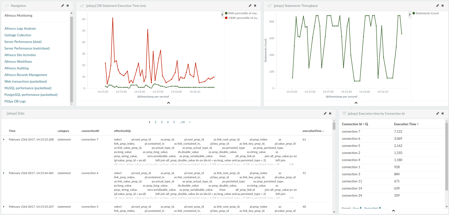

Database performance can be monitored with two different tools: p6spy and packetbeats. The main difference between these tools is that p6spy acts as a proxy jdbc driver and packetbeat is a network traffic sniffer. Also packetbeat can only sniff traffic for MySQL and PostgreSQL databases while p6spy can also do Oracle among others.
P6spy
P6spy software is delivered as a jar file that needs to be placed in the application class path i.e. tomcat/lib/ folder. There are 3 steps to get p6spy configured and running.
- Place p6spy jar file in tomcat/lib/ folder
- Create spy.properties file also in tomcat/lib/folder with the following configuration
modulelist=com.p6spy.engine.spy.P6SpyFactory,com.p6spy.engine.logging.P6LogFactory,com.p6spy.engine.outage.P6OutageFactory appender=com.p6spy.engine.spy.appender.FileLogger deregisterdrivers=true dateformat=MM-dd-yy HH:mm:ss S appender=com.p6spy.engine.spy.appender.FileLogger autoflush=true append=true useprefix=true # Update driver list correct driver i.e. # driverlist=oracle.jdbc.OracleDriver # driverlist=org.mariadb.jdbc.Driver # driverlist=org.postgresql.Driver driverlist=org.postgresql.Driver # Location where spy.log file will be created logfile=/opt/logstash-agent/logs/spy.log # Set the execution threshold to log queries taking longer than 1000 milliseconds (slow queries only) executionThreshold=1000 |
Note: if there are no queries taking longer than the value in executionThreshod (in milliseconds) then the file will not be created.
Note: set the “logfile” variable to the logs folder inside the logstash-agent path as shown above.
- Add entry to tomcat/conf/Catalina/localhost/alfresco.xml file
Example for PostgreSQL:
<Resource defaultTransactionIsolation="-1" defaultAutoCommit="false" maxActive="275" initialSize="10" password="admin" username="alfresco" url="jdbc 6spy ostgresql://localhost/p6spy:alfresco" driverClassName="com.p6spy.engine.spy.P6SpyDriver" type="javax.sql.DataSource" auth="Container" name="jdbc/dataSource" /> |
Example for Oracle:
<Resource defaultTransactionIsolation="-1" defaultAutoCommit="false" maxActive="275" initialSize="10" password="admin" username="alfresco" url="jdbc 6spy racle:thin:@192.168.56.101:1521:XE" driverClassName="com.p6spy.engine.spy.P6SpyDriver" type="javax.sql.DataSource" auth="Container" name="jdbc/dataSource" /> |
Example for MariaDB:
<Resource defaultTransactionIsolation="-1" defaultAutoCommit="false" maxActive="275" initialSize="10" password="admin" username="alfresco" url="jdbc 6spy:mariadb://localhost:3306/alfresco" driverClassName="com.p6spy.engine.spy.P6SpyDriver" type="javax.sql.DataSource" auth="Container" name="jdbc/dataSource" /> |
Once the spy.log file has been processed the following information is show:
- DB Statements execution time over time
- DB Statements throughput over time
- Table showing individual DB statements and execution times
- DB execution times by connection id

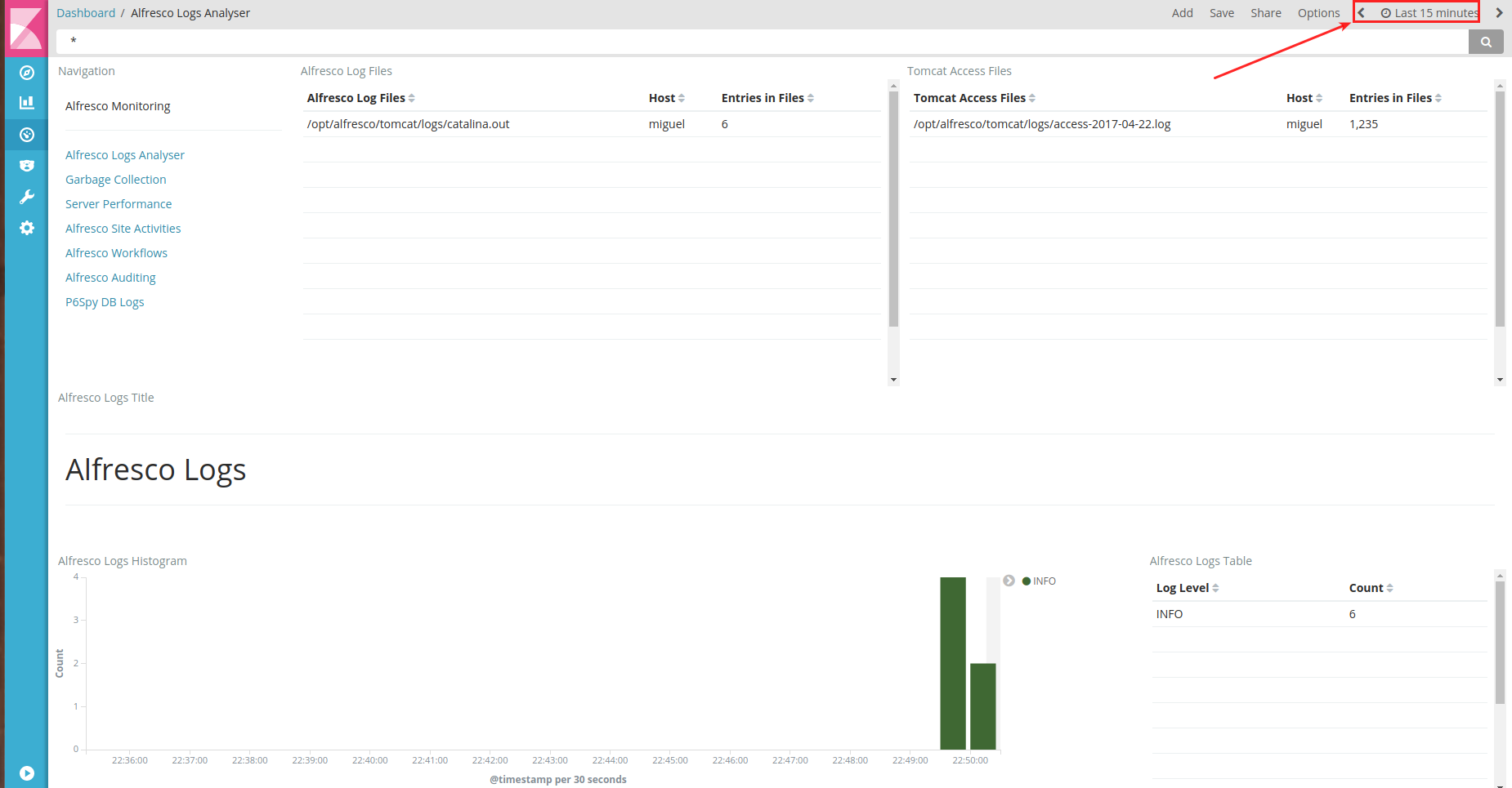

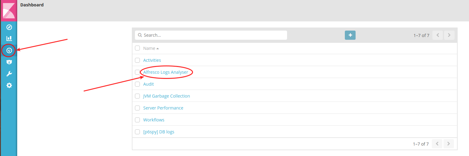

11. Accessing the Dashboard
Finally access the dashboard by going to this URL http://<docker host IP>:5601 (use the IP of the server where you installed the Docker container) and clicking on the “Dashboard” link on the left panel and then click on the “Activities” link.

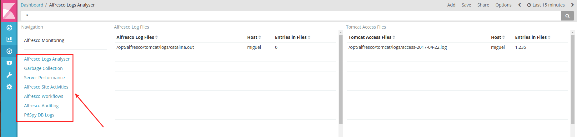

The data should be available for the selected time period.
Navigate to the other dashboards by clicking on the appropriate link.
