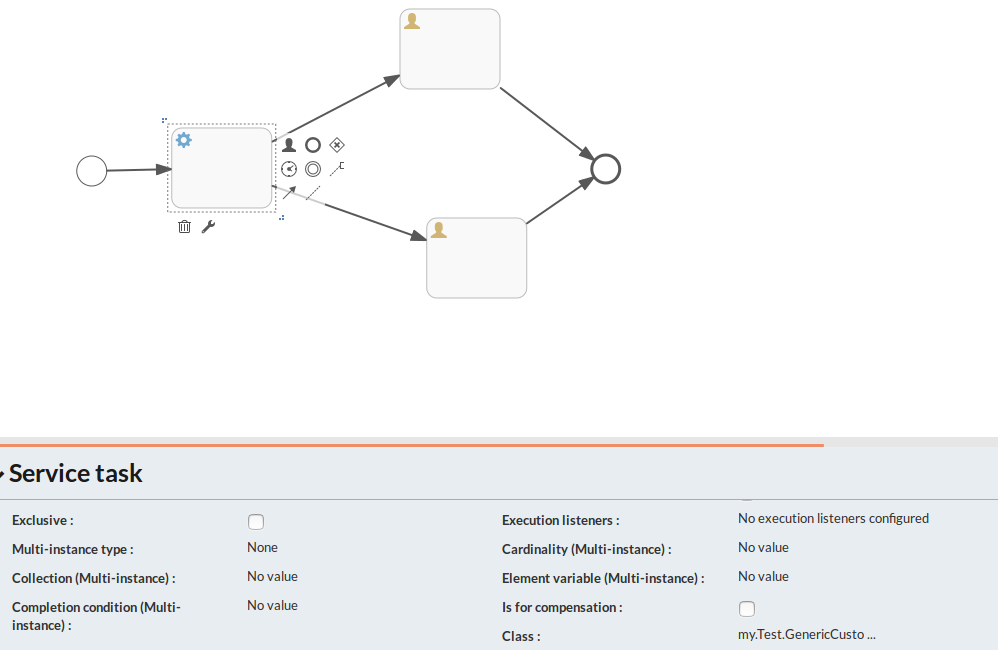

To apply your new java delegate you need to create a service task and apply under the class field the name of your class. Below are few screenshots how to do this:

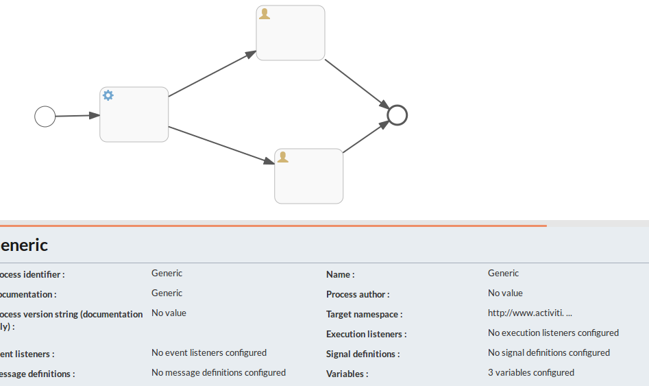

1. A very simple example workflow
2. Configure the global variable:

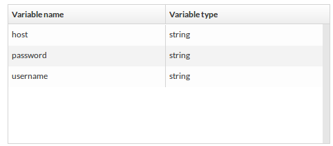

3. The variables set in step 2.
4. Setup the java delegate (adding the class name to the "class" field:

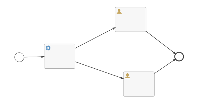

I created 2 forms for testing that my Java delegate is loaded correctly.
If the host variable will be empty the process should go one way and if it is correct it should go to the form that will display text with all our information of the file properties

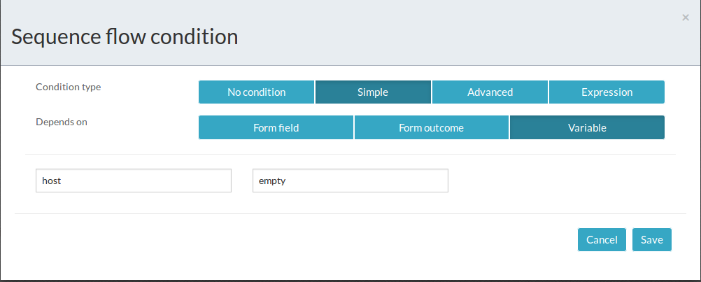

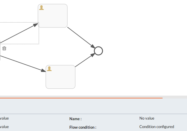

1. Create the condition on one arrow :
2. Enter the condition (host: not empty) that will allow to the form success:

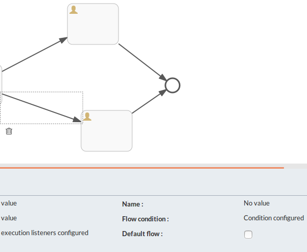

3. And the second condition:

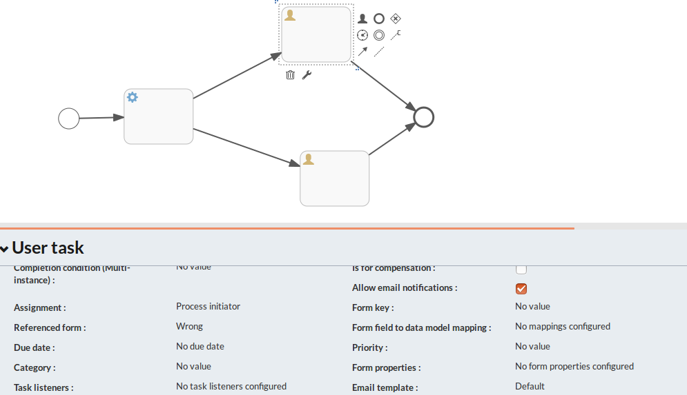

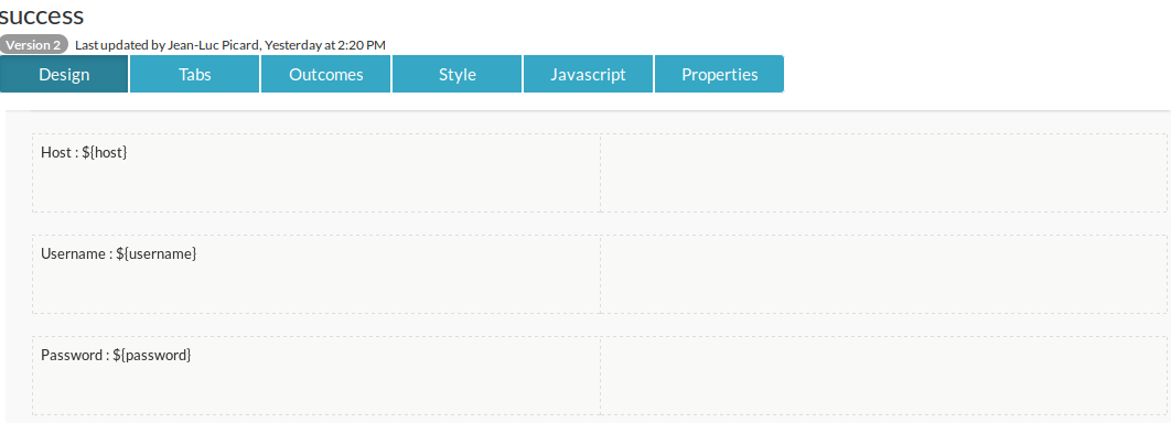

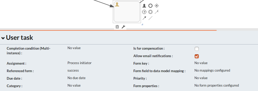

If the host is not empty the process should go to the human task with the following form:
The reference form here is "success" and this is how it looks like:

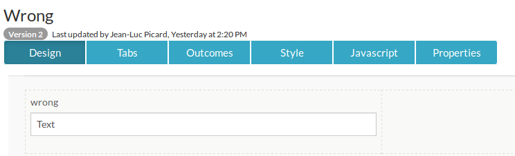

Otherwise, if there is some problem from the java delegate it will go to the other form called "wrong":
