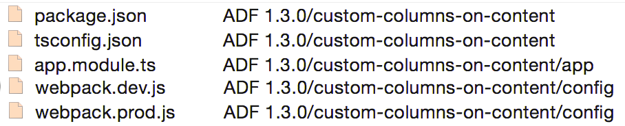

The files modified during the manual update are:
Below a brief description of the changes for each file.
