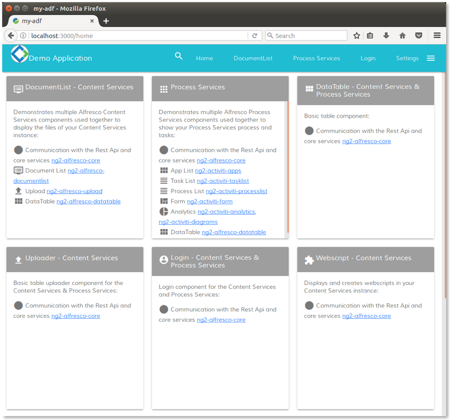

Assuming you have the my-adf application up and running, created in the same way it is described in the ADF 101 tutorial, let’s see how the home page looks like, once you successfully login.
Home page of my-adf application.

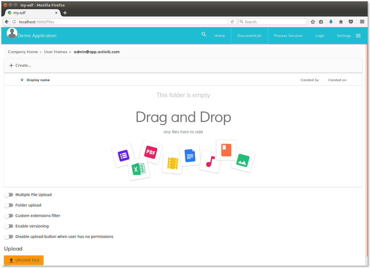

Let’s click on the DocumentList - Content Services content or on the DocumentList item in the upper menu, to access to the content service view. As you can see, the view shows the repository, similarly on what you probably use in Alfresco Share. By default you land into the user home, as shown in the picture below. Diving into the repository structure using the breadcrumb, a classical tree structure will be easily available for your discovery.
Content service view into the my-adf application.
Starting from the top of the view, we can recognize: the upper menu in cyan, the repository breadcrumb, the repository explorer (with a Create button), some buttons and checkboxes as an example of shortcuts and settings, the upload button. Below we are going to see the technical details behind the view.

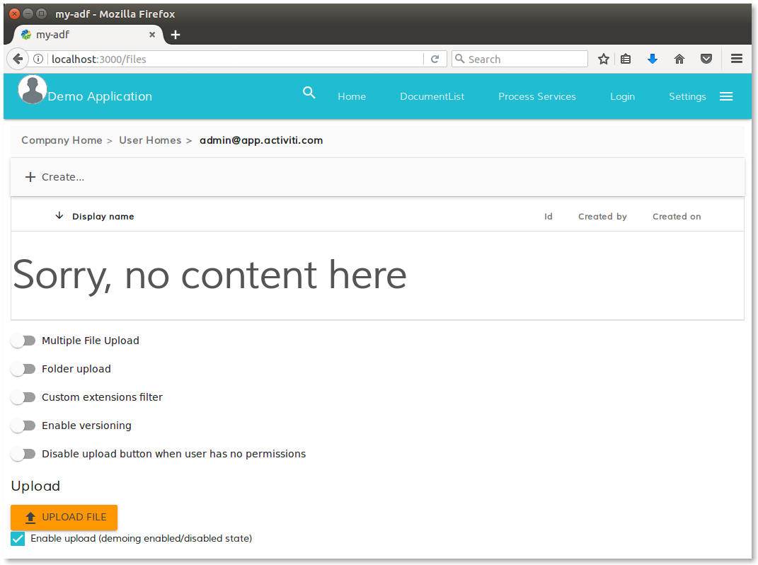

Saving the files.component.html file, you will see that the application will be automatically updated. Removing the comments related to the empty-folder-content tag, a custom message is shown in case of empty folder. In the picture below, you can see how the view looks like, in case of an empty folder.
Example of custom message for empty folder, in the alfresco-document-list view of the my-adf application.

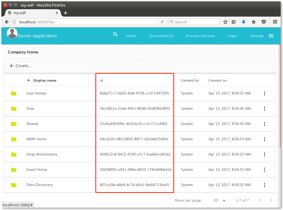

Adding the <span>data</span>-column tag, a new custom column containing the Alfresco node identifier is showed into the view. In the picture below, you can see how the view looks like in case of a folder with content. Bordered in red you can find the place where the new column is shown for each folder or document.

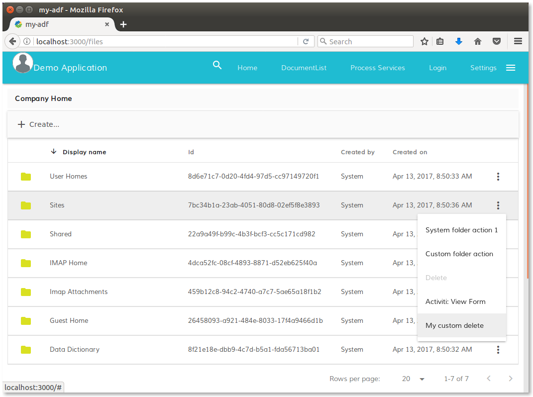

Saving the files.component.html file, you will see that the application will be automatically updated. In the picture below, you can see how the view looks like, selecting the actions in a folder.
Example of custom action for folders in the my-adf application.

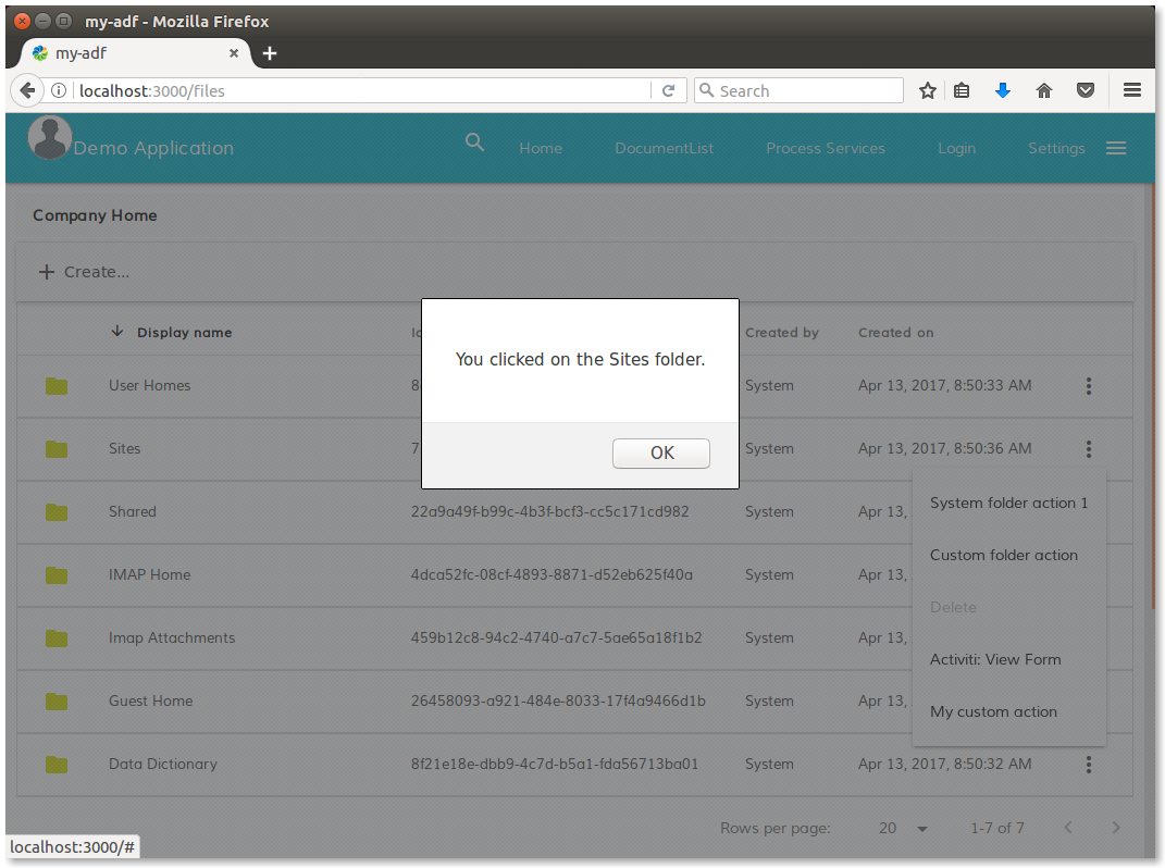

}Saving the files.component.html and files.component.ts files, you will see that the application will be automatically updated. In the picture below, you can see how the view looks like, selecting the actions in a folder and clicking on My custom action item.
Example of custom action on a custom function for folders in the my-adf application.
