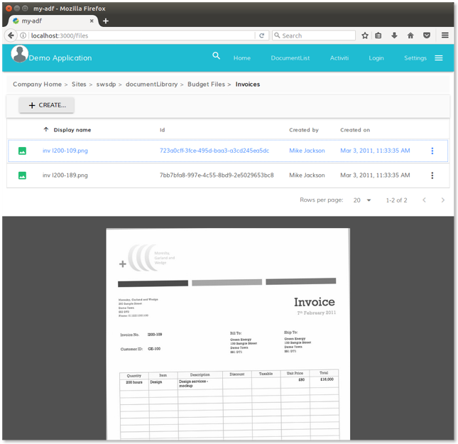

According to the ng2-alfresco-viewer documentation, the overlayMode attribute with value false will instruct the component to fit the preview into the parent div tag. In the picture below, you can see how the view looks like, previewing a document directly under the repository explorer.
Previewing a document in a predefined portion of the view, using the my-adf application.
