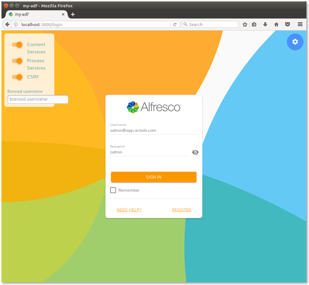

- Once the application is up and running, it will be available by default at the url http://localhost:3000. Open a browser, access to the login page and remember to use valid credentials for Activiti BPM and Alfresco ECM (for this purpose we suggest to create a new user with Administrator’s permits into Alfresco with username admin@app.activiti.com and admin as password).
Below the login page that will appear into the browser, at your first access.
Login form for your first application using Alfresco ADF.

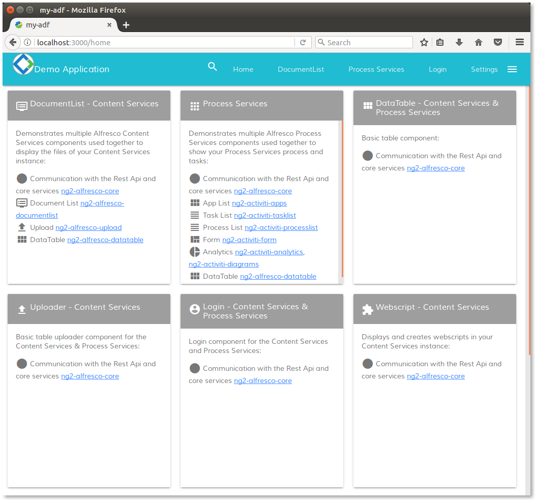

Once you login with success, the home page below will be shown into your browser.
Home page of your first application using Alfresco ADF.
