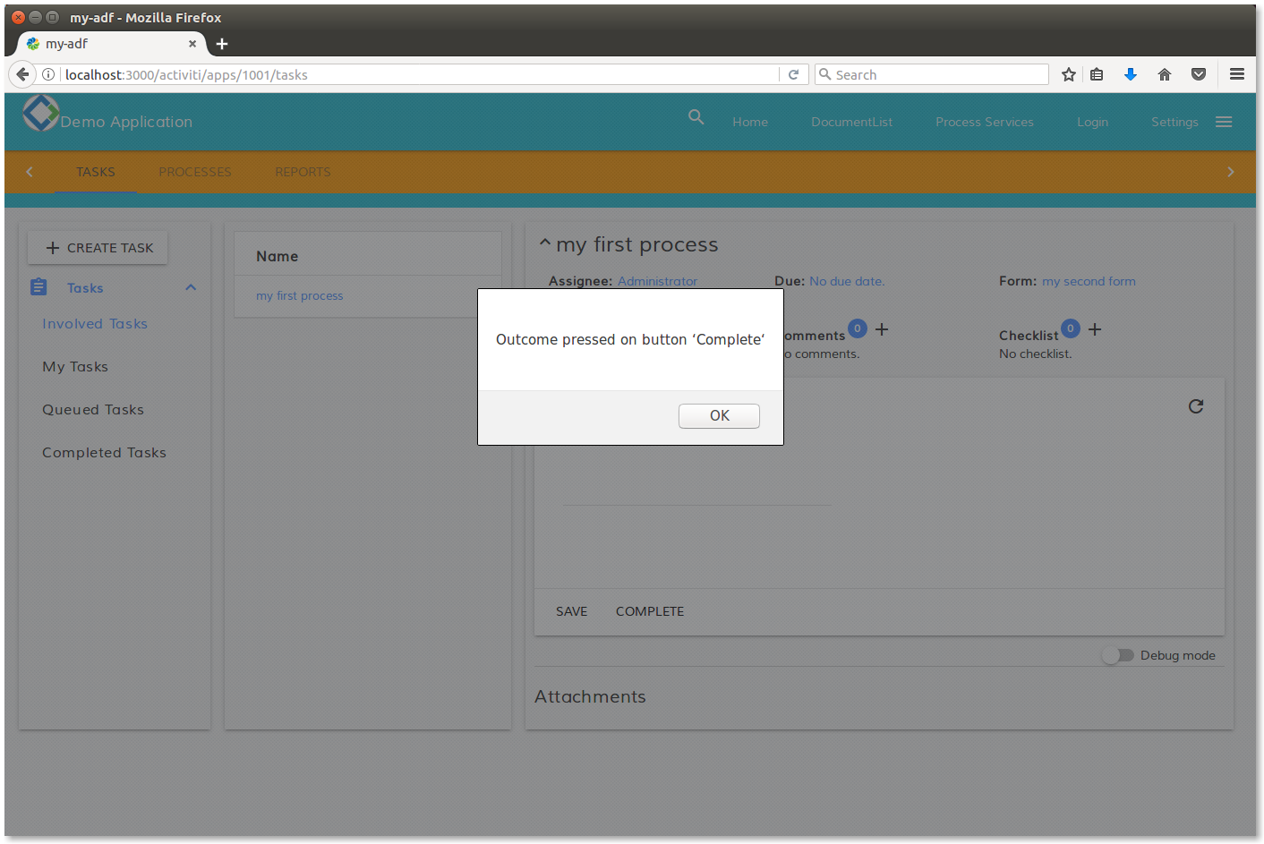

Task outcomes in action
In the pictures below we can see two different screenshots, depending on the pressed button. The first, pressing the Complete button. The second, pressing the Save button.
Message shown pressing the Complete button.
Message shown pressing the Save button.
