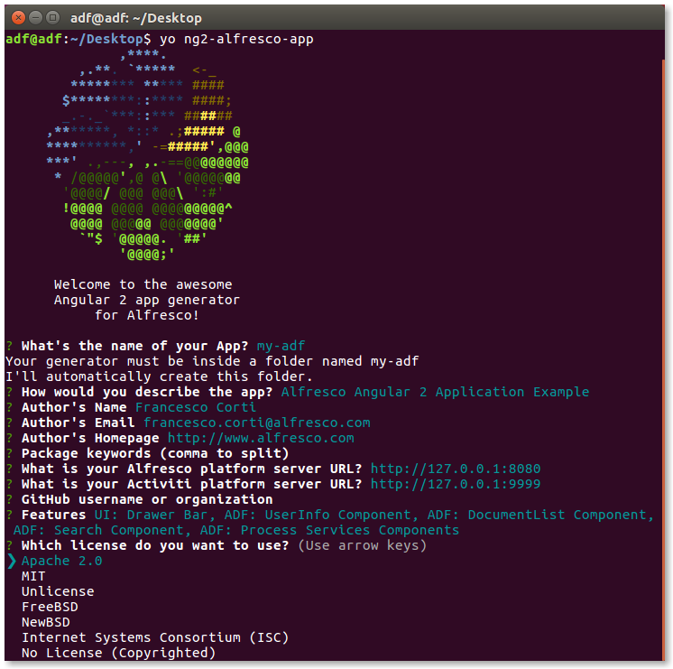

yo ng2-alfresco-app
During the execution, some questions will be asked to correctly create the application. Below a screenshot showing the questions as an example.
Alfresco App Generator wizard.
Once all the questions will be fully completed, a new folder appears, named with the same name of your application (in this case my-adf). The folder represents the source code of your new project created with Alfresco ADF.
From now on, your project is defined in its initial (but working) version so you can: move it into another destination, start developing and customizing it, commit the source code into your preferred repository.
