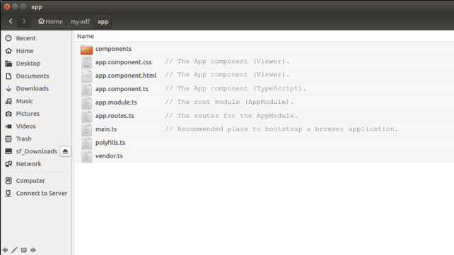

app folder. This folder contains the core content of the Angular 4 application, defined by the root module and the components. In the following picture is showed the corresponding app folder of our my-adf application.
Structure of the app folder into the file system.
Below some highlights on the most important content in the app folder.
main.ts This is the TypeScript file used for bootstrapping. This file indicates where to start bootstrapping, using the AppModule class (the Angular 4 root module) declared into the app.module.ts file.
app.module.ts This is the TypeScript file containing the AppModule class (the Angular 4 root module). This class defines:- The list of Angular 4 components, used in the application. In this specific application they are hosted into the components folder.
- The Angular 4 routing to enable the navigation from one view to the next. The routing rules are declared into the app.routes.ts file.
- The bootstrapping component, in our case named AppComponent, stored into the app.component.* files.
app.component.css, html and ts Those files define a standard Angular 4 component, controlling a patch of screen called a view. In particular:app.component.css defines the specific stylesheet of the component.app.component.html defines the HTML generated by the component (in this case, exactly where the tag <alfresco-app> appears into the index.html file).app.component.ts is the TypeScript file declaring the AppComponent class implementing the real business logic (and behavior) of the component.

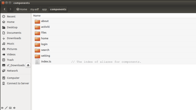

components folder. This folder contains all the Angular 4 components used in the application. In the following picture is showed the corresponding components folder of the my-adf application.
Structure of the components folder into the file system.
In the components folder you can find: one folder for each Angular 4 component (each folder contains the component source code), an index.ts file containing the links between the alias of each component and the folder with the source code.
The implementation of each Angular 4 component, really depends on the component’s role and goal in each specific application. We won’t detail here the listed components, because some of them are extremely specific for this sample application. Instead of this, we would like to submit to your attention the online Alfresco Catalog, containing a friendly (and technical) overview of all the available components, with practical examples and human readable source code.
