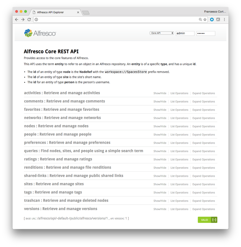

1.2.3. Installing REST API Explorer (Optional)
Even though other setup wouldn't be required, the Alfresco REST API Explorer could be evaluated to be installed, especially if you are defining a development environment. The Alfresco REST API Explorer gives you an interactive documentation for the Alfresco REST API, through the installation of a simple web application. To make it extremely simple, we will deploy the REST API Explorer directly into the Alfresco’s servlet container (by default Tomcat).
To install the Alfresco REST API Explorer please follow the steps described below.
https://artifacts.alfresco.com/nexus/service/local/repositories/releases/content/org/alfresco/api-explorer/1.4/api-explorer-1.4.war
- Restart Alfresco. You’ll be able to reach the REST API Explorer at the link below.
http://<alfresco_ip>:<alfresco_port>/api-explorer-1.4/
Want to see how the Alfresco REST API Explorer looks like? You can have a preview at the link below.
https://api-explorer.alfresco.com/api-explorer/
Fig.2 - Alfresco REST API Explorer

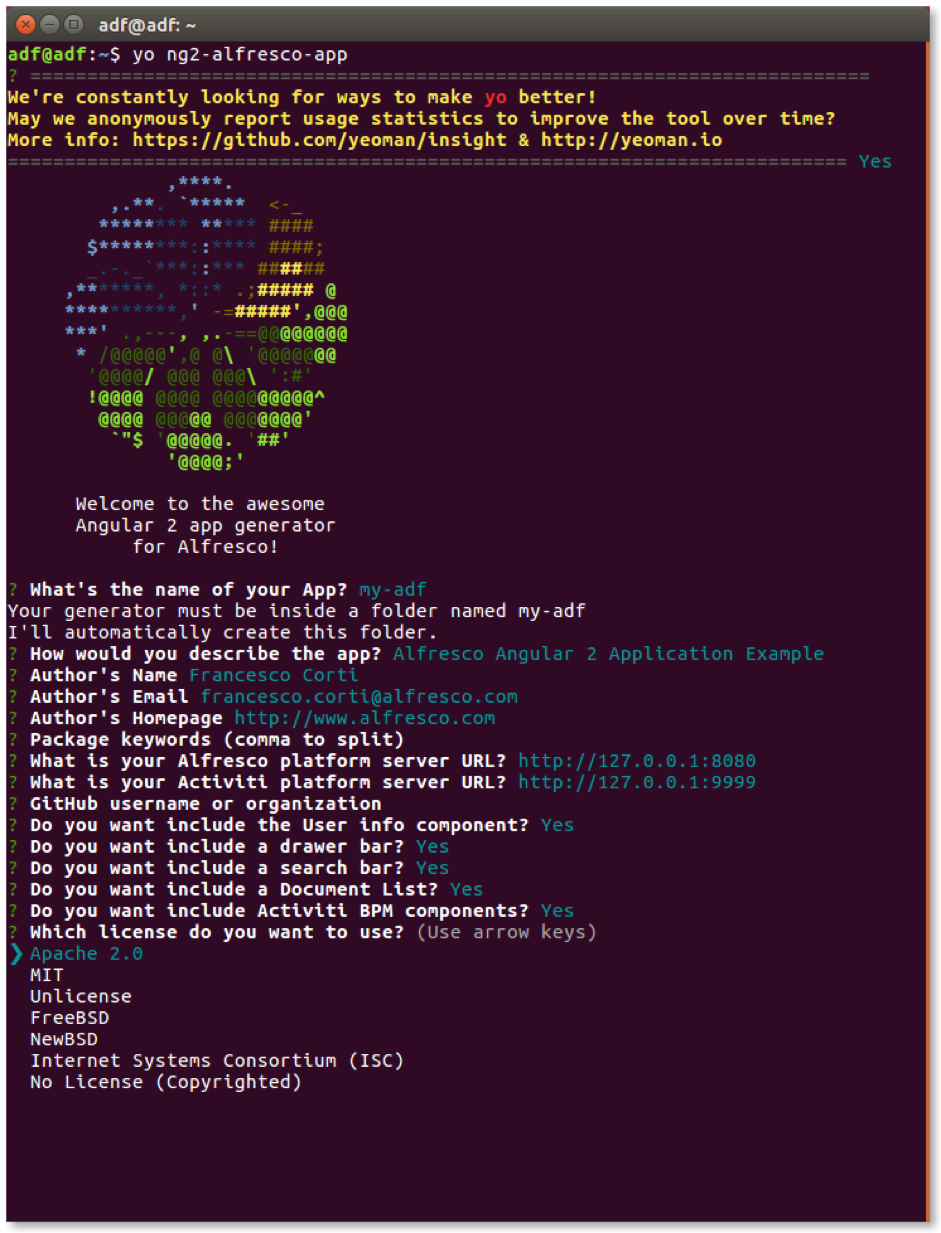

2.3. Generating your first Alfresco ADF application
Once your environment is correctly set up, it’s time create the Alfresco ADF application. Creating your first application with Alfresco ADF is very straightforward following the commands described below.
- Open a terminal and move to a folder where you want to create your project.
yo alfresco-adf-app
During the execution, some questions will be asked to correctly create the application. Below a screenshot showing the questions as an example.
Fig. 4 - Alfresco App Generator wizard.
Once all the questions will be fully completed, a new folder appears, named with the same name of your application (in this case my-adf). The folder represents the source code of your new project created with Alfresco ADF.
From now on, your project is defined in its initial (but working) version so you can: move it into another destination, start developing and customising it, commit the source code into your preferred repository.

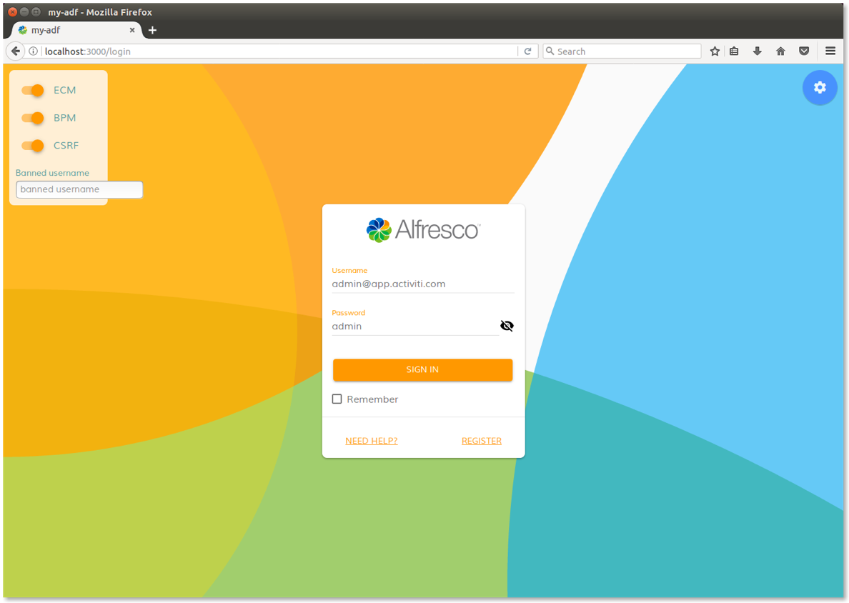

- Once the application is up and running, it will be available by default at the url
http://localhost:3000. Open a browser, access to the login page and remember to use valid credentials for Activiti BPM and Alfresco ECM (for this purpose we suggest to create a new user with Administrator’s permits into Alfresco with username <a class="jive-link-email-small" href="mailto:admin@app.activiti.com" rel="nofollow noopener noreferrer">admin@app.activiti.com</a> and admin as password).
Below the login page that will appear into the browser, at your first access.
Fig. 5 - Login form for your first application using Alfresco ADF.

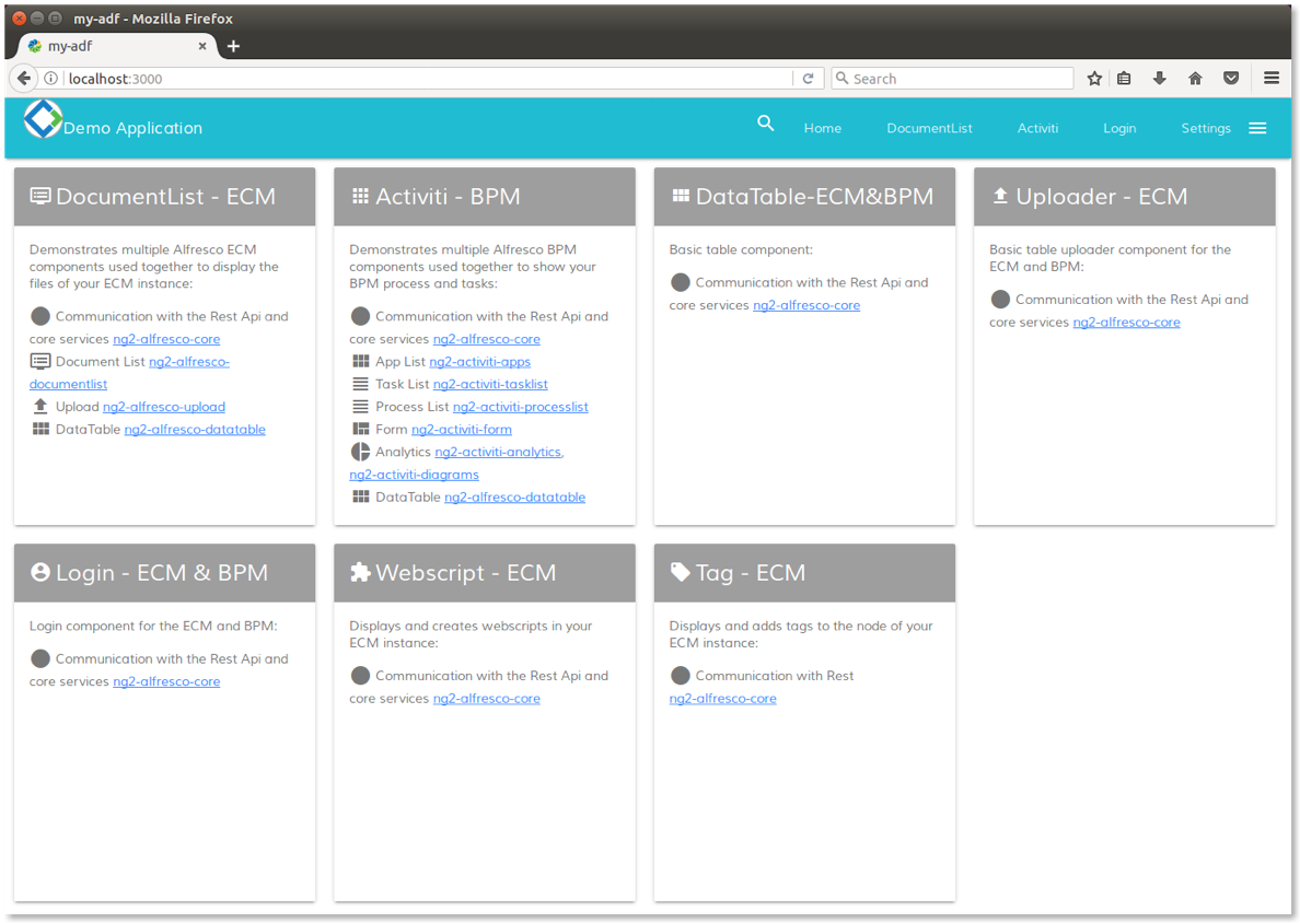

Once you login with success, the home page below will be shown into your browser.
Fig. 6 - Home page of your first application using Alfresco ADF.
