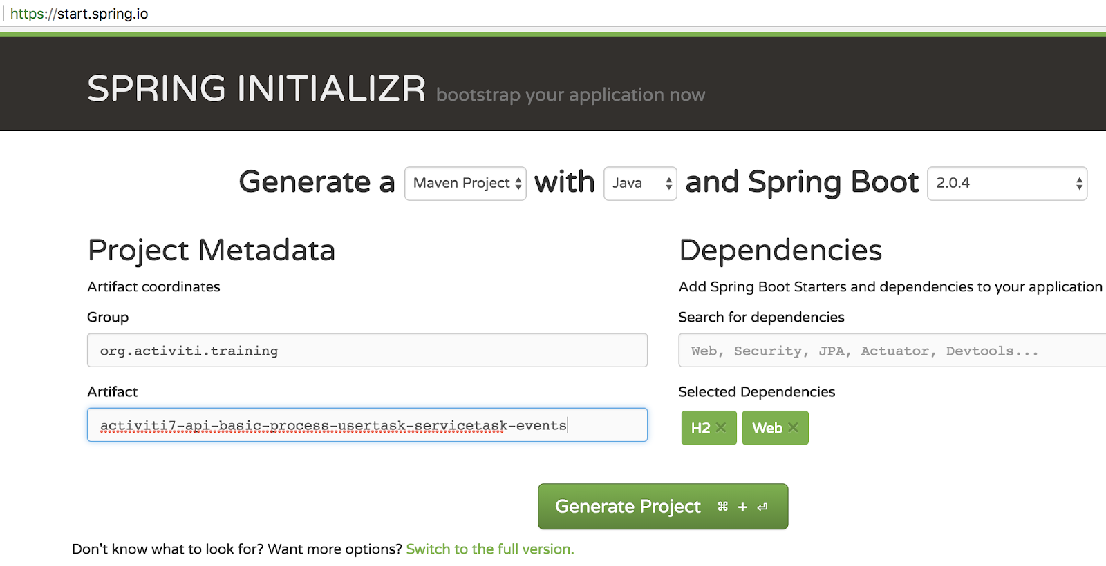

Generating a Spring Boot 2 App
It’s really easy to get going with a Spring Boot application. Just head over to https://start.spring.io/ and fill in the data for the app as follows:
Make sure to use Spring Boot version 2.0.x with Activiti 7 Beta 1 - 3, Beta 4 should be aligned with version 2.1.x.
You don’t have to use the same Group (org.activiti.training) and Artifact (activiti7-api-basic-process-usertask-servicetask-events) names as me, just use whatever you like. However, if you copy code from this article it might be easier if you use the same package names (i.e. the same group). Search for the H2 and Web dependencies so they are included in the Maven POM. Then click the Generate Project button. The finished Spring Boot 2 Maven project will automatically download as a ZIP. Unpack it somewhere.
