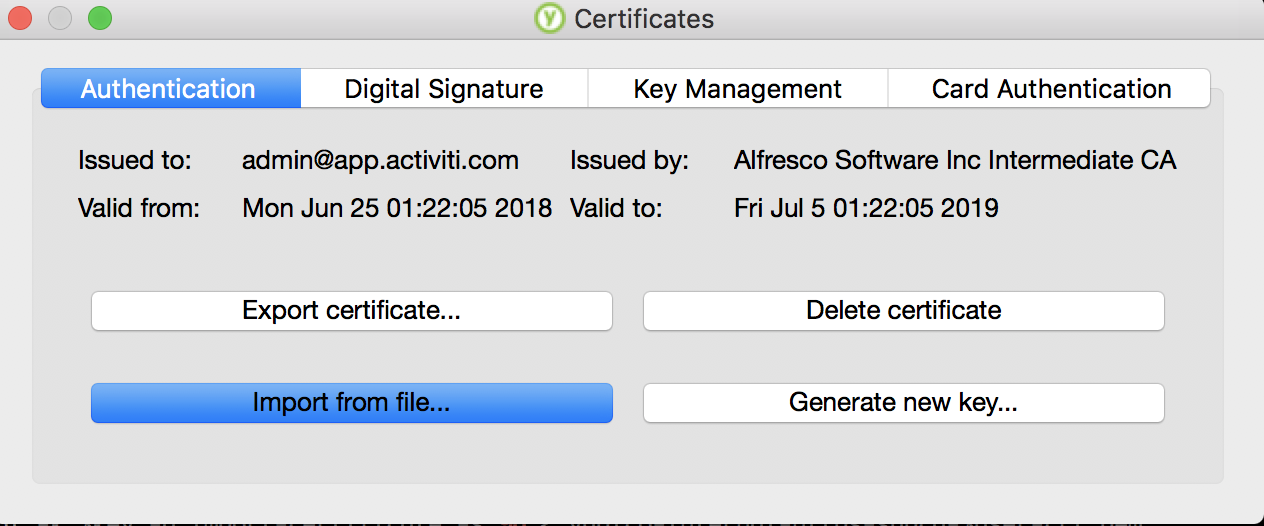

Verify certificates using YubiKey PIV Manager
This is an optional step. The YubiKey PIV Manager enables you to configure a PIV-enabled YubiKey through a graphical user interface. Once the certificate and key is imported, you can verify the imported certificates via this utility. The installer can be found here. When a certificate is successfully loaded into the authentication slot of your Yubikey, the PIV manager will display it as shown below.

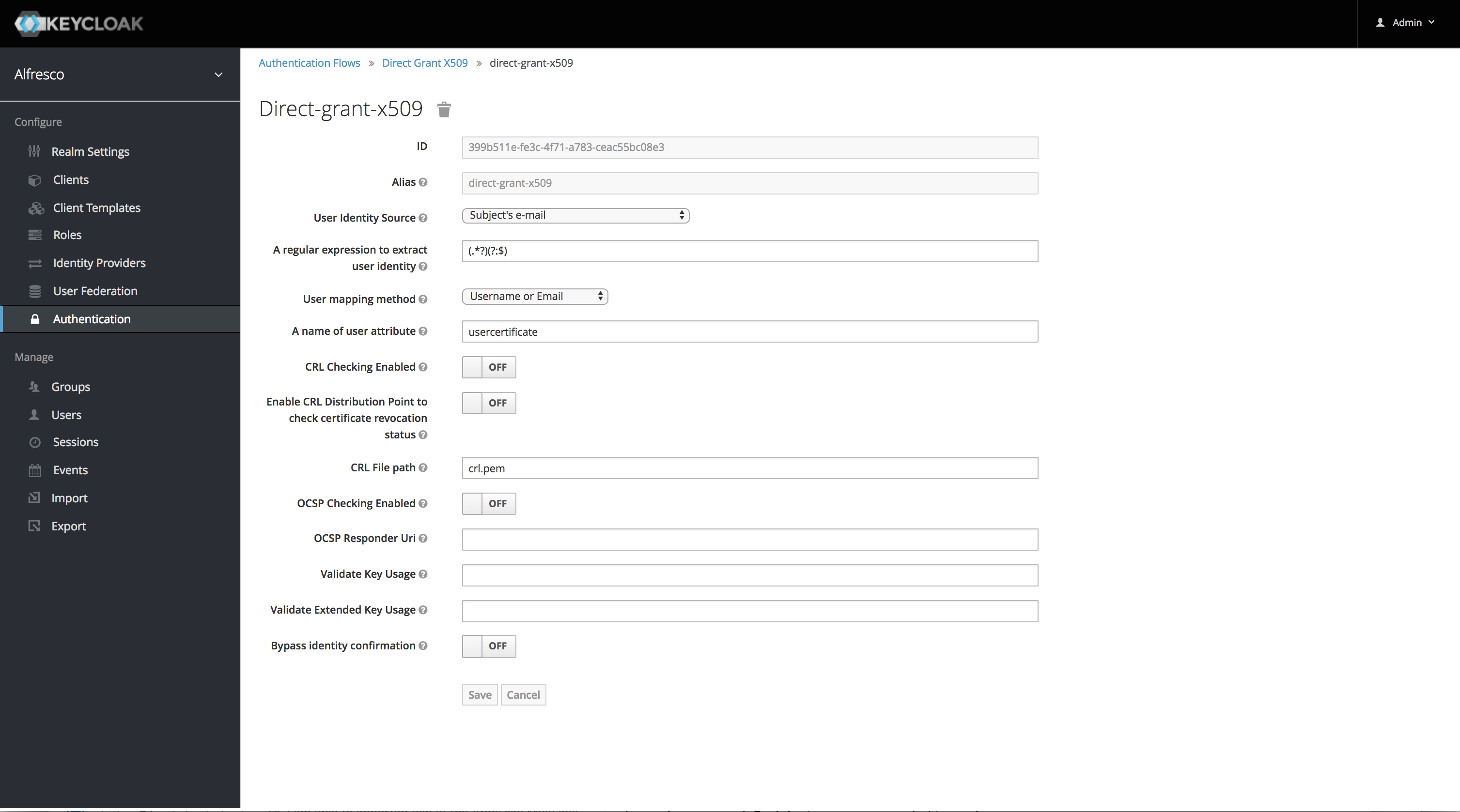

Configure Direct Grant
Configuring direct grant is the easiest way to verify the configuration. For more details refer adding-x-509-client-certificate-authentication-to-a-direct-grant-flow. Screenshots below:

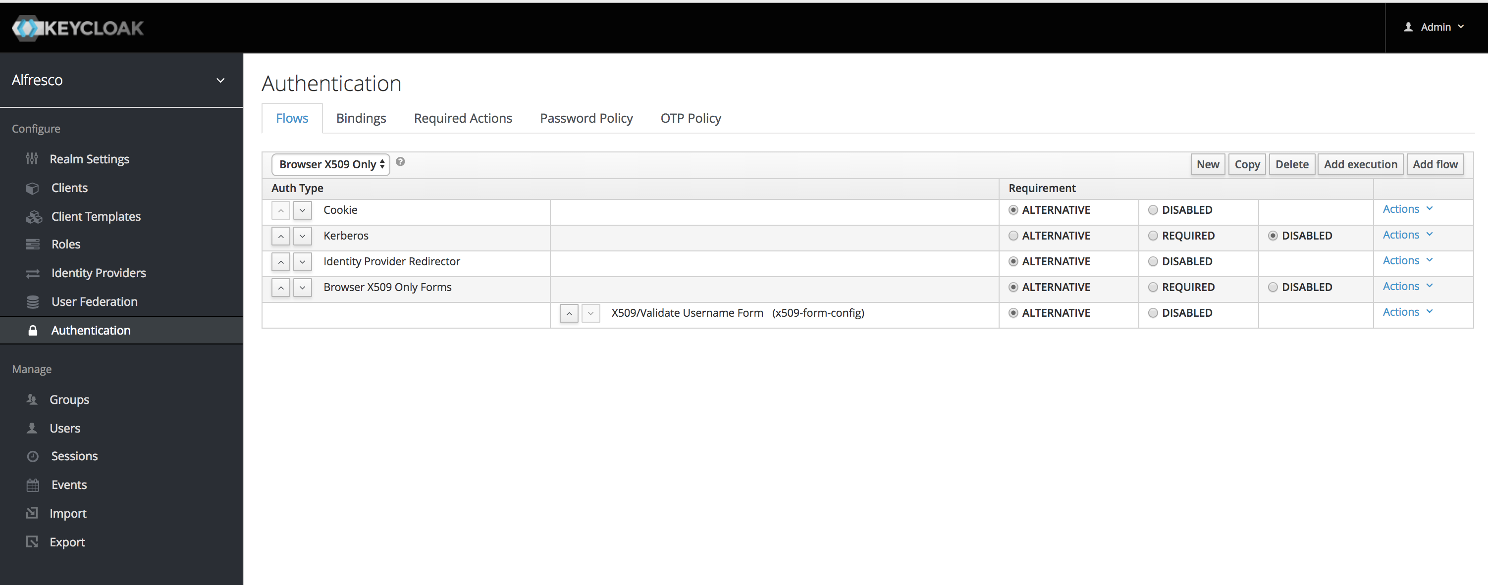

Configure Browser Flow
The following screenshots will show how to configure the browser flow to use X.509 authentication. For more details, please refer adding-x-509-client-certificate-authentication-to-a-browser-flow. Screenshots below:
