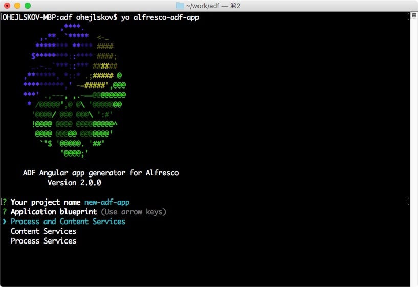

Next up, let's generate our application with Yeoman:
$ yo alfresco-adf-app
The generator will now ask a few questions, mainly the name of your app, and which blueprint you want to use:
You can select one of three blueprints. To describe them from the bottom up:
Process Services
This will generate an application for Alfresco Process Services. It contains the following components: Login, App List, Task List, Form and Start Process.
Content Services
This will generate an application for Alfresco Content Services (or Alfresco Community Edition). It contains the following components: Login, Document List, Viewer.
Process and Content Services
This will generate an application for both Alfresco Process and Content Services and will be a combination of the two blueprints above.
Select the one you want to use, and the generator will now ask if you want to install dependencies right away. Enter "Y" and hit enter.

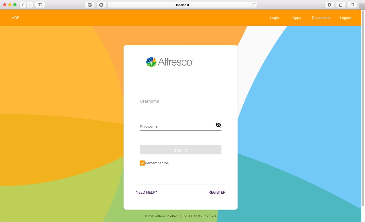

Now you can simply run "npm start". This takes a couple of seconds, and will automatically open a browser to http://localhost:4200/. Once the page loads, you can navigate to http://localhost:4200/login which should look like this:
Enter a valid username and password and you have now successfully created your very first ADF 2.0 application!
