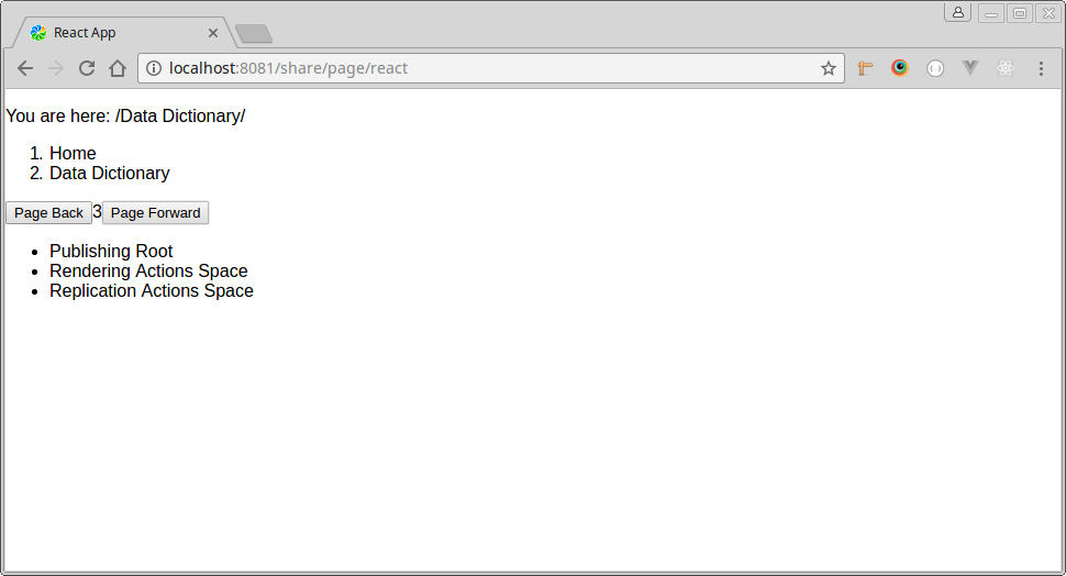

Create Your Page
You should now have an application running locally with a great development experience with hot-reloading, etc provided by create-react-app. If you make an REST API call to (using an URL starting with /share/proxy/alfresco) then you should get a basic authentication challenge and once you've provided some valid credentials you'll be able to access data from the Alfresco Repository (don't worry, when you deploy into Share the authentication will be handled for you by Share/Surf).
I've built a very simple client for browsing company home. You can view/copy the code from this GitHub repository (check out this tag for the code at the time of writing this post). The client contains 4 components:
- List
- ListView
- Breadcrumb
- Toolbar
...that provide a simple interface for browsing.

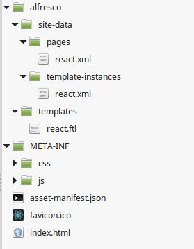

- Copy the build folder to a new location
- Rename the static folder to be "META-INF"
- Create the following files:
- alfresco/site-data/pages/react.xml
- alfresco/site-data/template-instances/react.xml
- alfresco/templates/react.ftl
Your folder should now look like this:
Now update the files as follows:

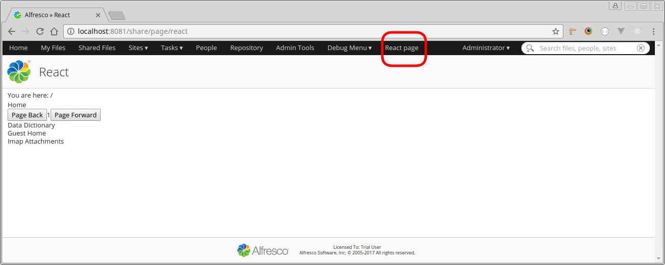

Add a Link to the Header
Obviously it's not ideal for users to have to enter a URL into the browser to get to your new page so let's add a link into the header bar.
This Stack Overflow question and answer provides a good overview on doing this properly (go on, give it an up vote - you know you want to!) but the basic steps in this case are as follows:

} - Repack your JAR file, deploy it to /share/WEB-INF/lib and restart the server
Now on each page in Share you'll see a link to your new page:
