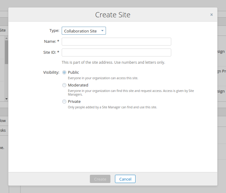

If you have already made significant customizations to the the YUI2 based versions of the dialog then don't panic. We've provided a very simple way in which to use the old dialogs so that your existing customizations can continue to work just as they've always done. The SiteService that controls which dialogs are used has a legacyMode configuration attribute that when set to true will use the YUI2 dialogs. In Share 5.2 we are re-configuring this to be false so if you want to continue using the YUI2 dialogs you just need to create an extension that configures it back to true again!

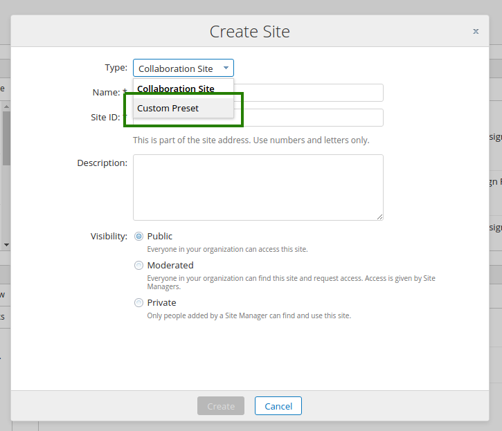

Alfresco only comes with a single site preset (the "Collaboration Site"). In order to make more site presets show up in the old dialog it was necessary to create an extension module to customize the create-site.get.js WebScript JavaScript controller. All customization is now done via the SiteService and you now have options to:
- Explicitly define the presets (via the sitePresets attribute)
- Provide additional presets (via the additionalSitePresets attribute)
- Remove existing presets (via the sitePresetsToRemove attribute)
Let's add some additional presets. In the share-header.get.js customization file create the following:
var siteService = widgetUtils.findObject(model.jsonModel, "id", "SITE_SERVICE");
if (siteService && siteService.config)
siteService.config.additionalSitePresets = [{ label: "Custom Preset", value: "CUSTOM" } ];
}This will add the additional preset into the create site dialog, like so:

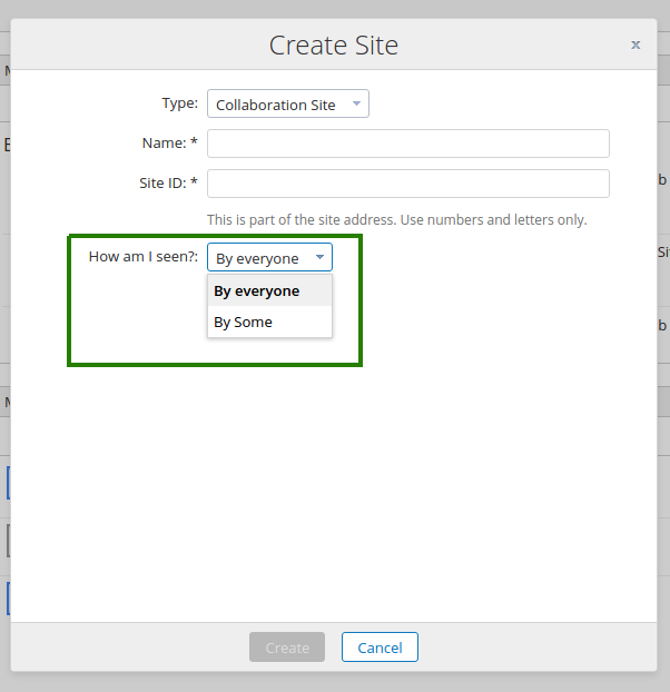

There are two ways in which you can update an existing field. The first method is using the replace attribute. As the name suggests this will completely replace any widget with a matching id. Add the following entry into the widgetsForCreateSiteDialogOverrides array:
replace: true,
config: {
fieldId: "VISIBILITY",
label: "How am I seen?",
optionsConfig: {
fixed: [
label: "By everyone",
value: "PUBLIC"
label: "By Some",
value: "MODERATED"
}...and the result is that the original RadioButtons widget is replaced by a Select widget like this:

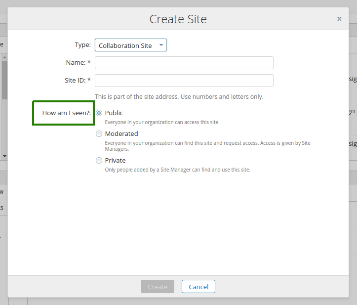

If you just want to merge some existing configuration into an existing field then you can just omit the replace attribute and just provide the new or changed attributes. Change the replace entry to be this:
config: {
}This has the effect of simply updating the label displayed:

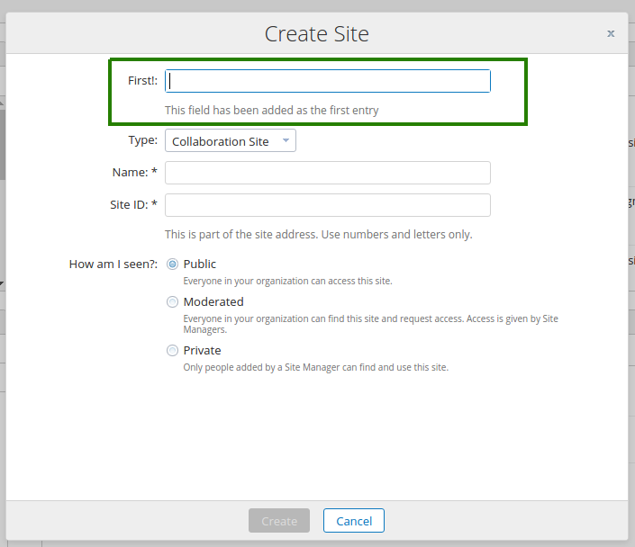

For example, let's say that you want to add a new field at the start of the dialog. Add the following entry into the widgetsForCreateSiteDialogOverrides array:
targetPosition: "START",
config: {
fieldId: "FIRST",
label: "First!",
description: "This field has been added as the first entry"
}This will result in the following dialog:

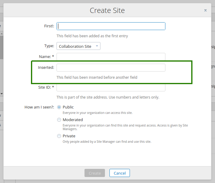

If you wanted to insert a field between the "Site ID" and "Name" fields then use a combination of targetPostition and targetId like this:
targetPosition: "BEFORE",
targetId: "CREATE_SITE_FIELD_SHORTNAME",
config: {
fieldId: "INSERTED",
label: "Inserted",
description: "This field has been inserted before another field"
}This would then result in the following dialog:
