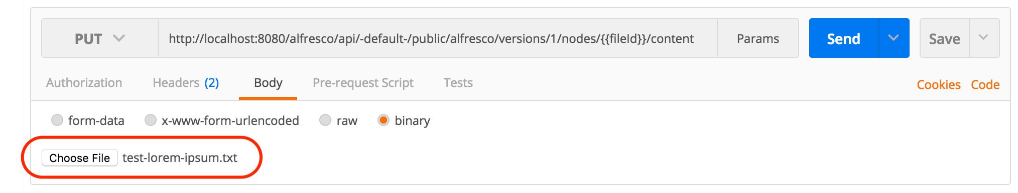

The PUT endpoint accepts any binary stream so we could also use Postman to choose a file to upload as shown in the screenshot below:
