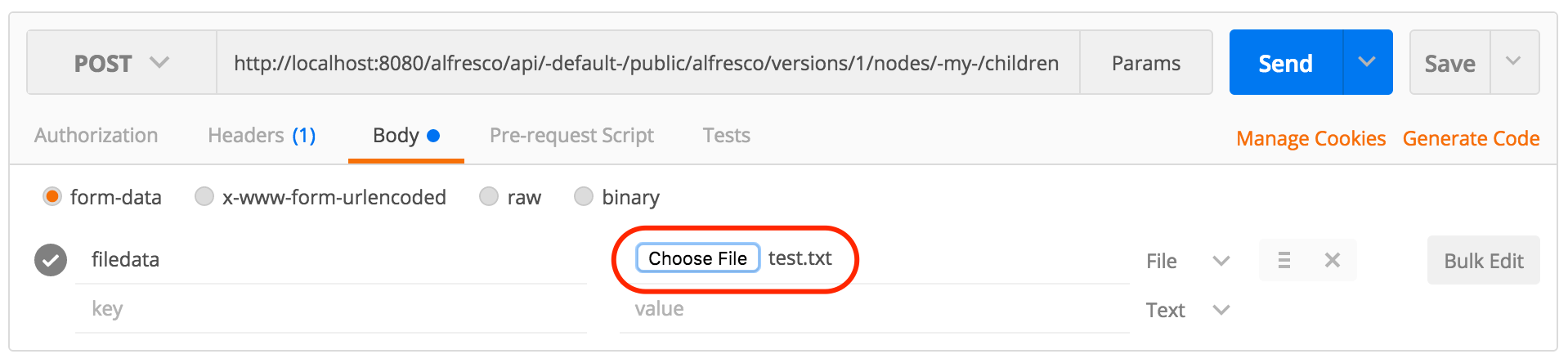

Alternatively, the 3rd request in the Postman collection can be used after selecting a file in the "Body" tab as shown in the screenshot below.
