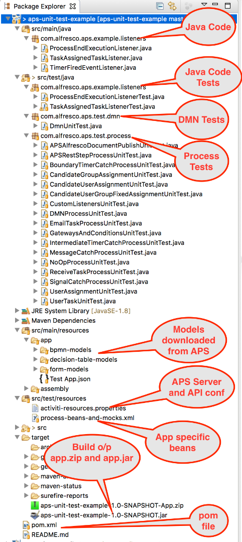

Project Structure
Before even we get to the unit testing part, it is very important to understand the project structure.
As you can see from the above diagram, this is a maven project. However, if you are a “gradle” person, you should be able to do it the gradle way too! The various sections of the project are:
- Main java classes - located under src/main/java. This includes all the custom java code that are supporting your process/dmn models.
- Test classes - located under src/test/java. The tests are again grouped into different packages depending on the type of units they are.
- Java class tests - This includes test classes for classes (eg: Java Delegate, Task Listener, Event Listener, Custom Rest Endpoints, Custom Extensions etc) under src/main/java.
- DMN tests - As you can see from the package name (com.alfresco.aps.test.dmn) itself, I’m writing all the DMN tests under this package. The pattern I followed in this example is one test class per DMN file under the directory src/main/resources/app/decision-table-models.
- Process(BPMN) tests - Similar to DMN tests, the package com.alfresco.aps.test.process contains all the BPMN test classes. Similar to DMN tests, I am following the pattern of one test class per BPMN file under src/main/resources/app/bpmn-models
- App models - All the models (forms, bpmn, dmn, data models, stencils, app.json etc) that are part of the process application is stored under the directory src/main/resources/app. When using the aps-unit-test-utils which I explained in the previous article, all the models are downloaded to this directory from APS. Once the tests are passed successfully, we will re-build the deployable process artifacts from this directory
- Test resources - As with any standard java projects, you can keep all your test resources in the directory src/test/resources. I’ll highlight a couple of files that you will find under this directory in the above project structure image
- activiti-resources.properties - This file contains the APS server configurations such as server address, api url, user credentials etc for downloading the process application into your maven project. Please refer to my previous article for a detailed explanation of this file. You wouldn’t find this file on GitHub under this project, the reason is, this file is intended to be developer specific and local to the workspace of a developer. For this reason this file is included in the project’s .gitignore file to prevent it from getting saved to GitHub.
- process-beans-and-mocks.xml - the purpose of this file is to mock any project/process specific classes when you run your process tests. The concept is explained in detail in my previous article when I explained a similar file called common-beans-and-mocks.xml.
- Build output - In the above screenshot you can see that there are two files named aps-unit-test-example-1.0-SNAPSHOT-App.zip and aps-unit-test-example-1.0-SNAPSHOT.jar under /target directory. This is basically the build output that gets generated when you package the app using maven commands such as “mvn clean package”. The “.zip” file is the app package created from src/main/resources/app directory which you can version after every build and deploy to higher environments. The “.jar” is the standard jar output including all the classes/resources from your src/main directory.
- Maven pom xml - Since this is a maven based project, you need a pom.xml under the root of the project. Highlighting some of the dependencies and plugins that are used in this pom.xml
- aps-unit-test-utils dependency - the test utils project which I explained in my previous post/blog.

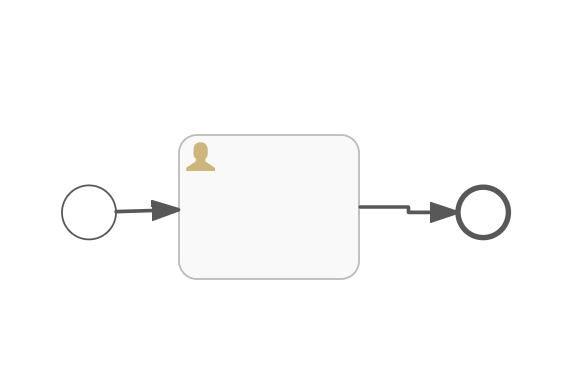

In this example we will test the following process diagram which is a simple process containing three steps Start → User Task → End
UserTaskUnitTest.java - test class associated with this process which tests the following
- A process is started correctly
- Upon start a user task is created and assigned to the correct user with the correct task due date
- Upon completion of the user task the process is ended successfully

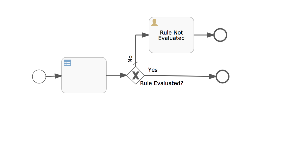

Let’s now look at a process that is a little more complex than the previous one. As you can see from the diagrams below, there are two units that are candidates for unit test in this model, they are process model & DMN model
- DMNProcessUnitTest.java - Similar to the above example, this is the test class associated with this process which tests the following:
- Tests all possible paths in the process based on the output of rule step
- Successful completion of process
- Mocks the rules step - when it comes to the rules/decision step in the process, we are not invoking the actual DMN file associated with the process. From a process perspective all we care is that an appropriate variable is set at this step for it to take the respective path that is being tested. Hence the mock.

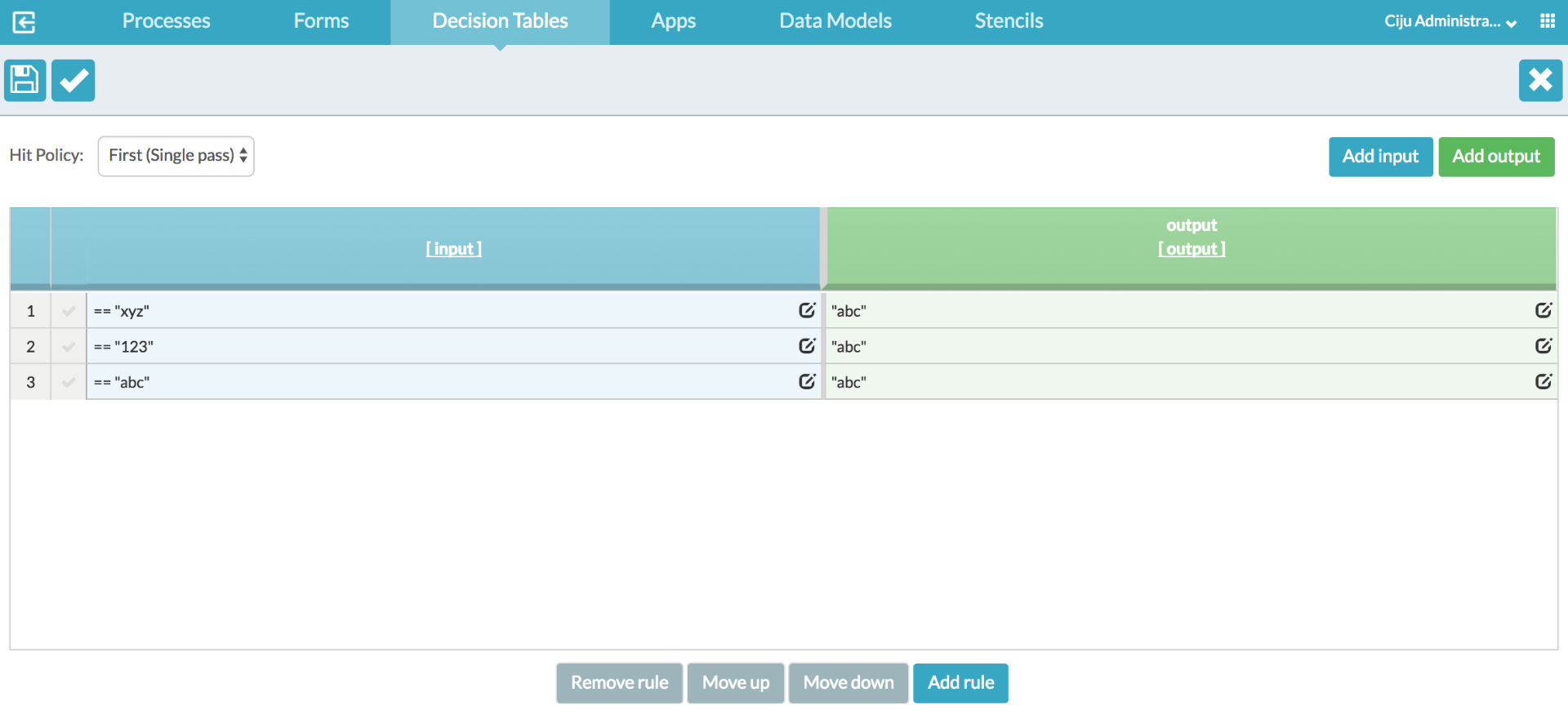

In this example we will test the following DMN model which is a very simple decision table containing three rows of rules.
- DmnUnitTest.java - the test class associated with the above DMN model. The test cases in this file will test every row in the DMN table and verify that it is getting executed as expected. The number of rules in real life can grow in size over time, hence it is important to have test cases covering all the possible hit and miss scenarios in your test cases for a healthy maintenance of your decision management and business rules.

result = ruleService.executeDecisionByKey(decisonTableKey, processVariablesInput);
Assert.assertNotNull(result);
Assert.assertEquals(1, result.getResultVariables().size());
Assert.assertSame(result.getResultVariables().get("output").getClass(), String.class);
Assert.assertEquals(result.getResultVariables().get("output"), "abc");
* Invoke with input set to abc and assert output is equal to abc
processVariablesInput.put("input", "abc");
* Test a miss
@Test
public void testDMNExecutionNoMatch() throws Exception {
Map<String, Object> processVariablesInput = new HashMap<>();
processVariablesInput.put("input", "dfdsf");
RuleEngineExecutionResult result = ruleService.executeDecisionByKey(decisonTableKey, processVariablesInput);
Assert.assertEquals(0, result.getResultVariables().size());
}Custom Java Class Testing
