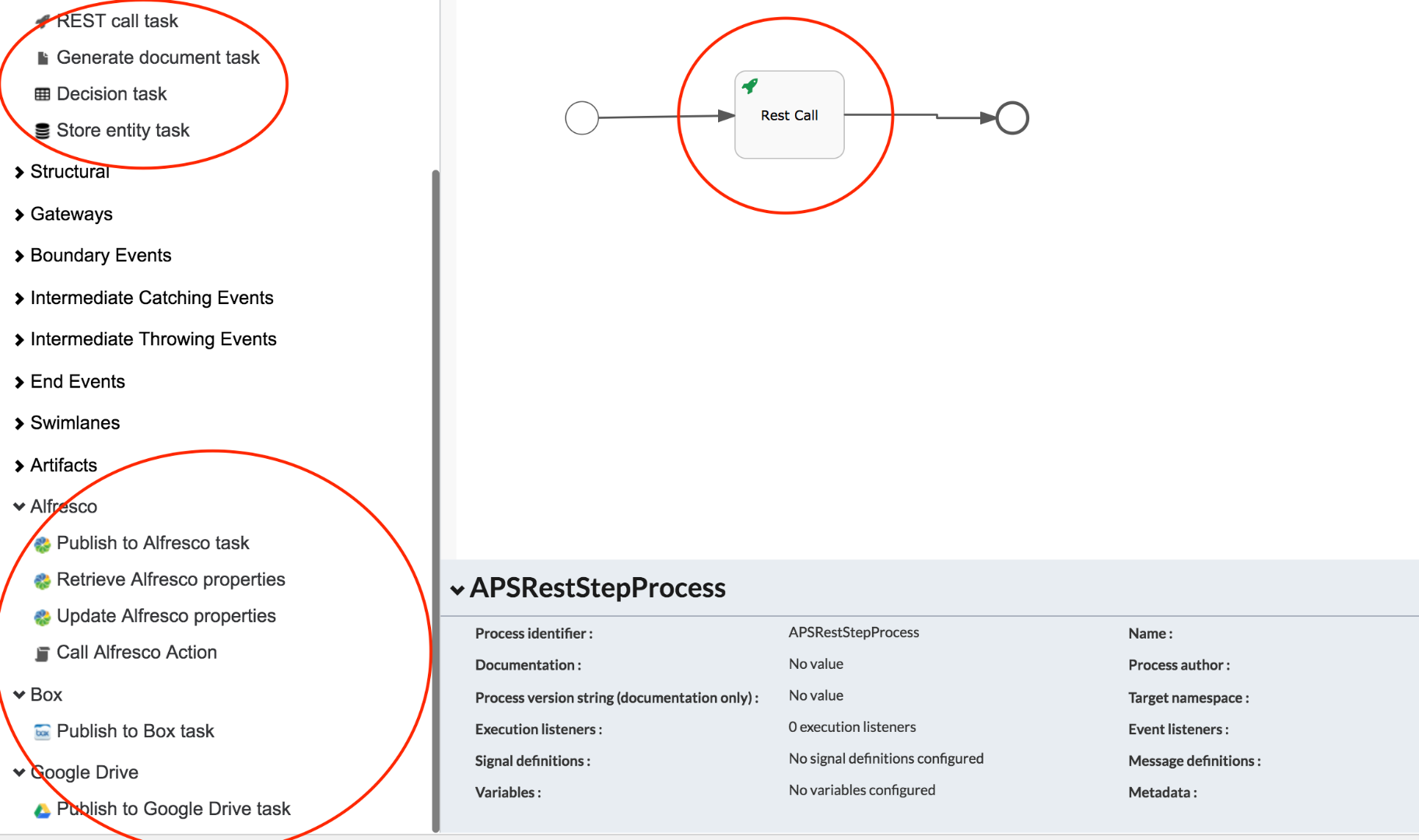

Since I think “mocks” are best explained with an example, please find below a process diagram where I’m using an OOTB APS “REST call task” stencil. I have also highlighted some of the other components in the APS editor that fall in this category of OOTB stencils.

This is where we use mocks instead of the real classes that are behind these components. In order to create the mocks for these components, we need to first look at how these tasks look inside the deployed bpmn.xml. For example the bpmn equivalent of the above diagram is shown below:
<serviceTask id="sid-AB2E4A5F-4BF6-48BE-8FF1-CDE01687E69A" name="Rest Call" activiti:async="true" activiti:delegateExpression="${activiti_restCallDelegate}">
<extensionElements>
<activiti:field name="restUrl">
<activiti:string><![CDATA[https://api.github.com/]]></activiti:string>
</activiti:field>
<activiti:field name="httpMethod">
<activiti:string><![CDATA[GET]]></activiti:string>
</activiti:field>
<modeler:editor-resource-id><![CDATA[sid-8124CB5D-BD47-49CD-B013-F7FFB576DE8D]]></modeler:editor-resource-id>
</extensionElements>
</serviceTask>As you can see from the XML, the bean that is responsible for the REST call is activiti_restCallDelegate. This bean also has some fields named “httpMethod”, “restUrl” etc. Let’s now look at the mock class (given below) that I created for this bean. Since it is a mock class, all you need to do is create a java delegate with the field extensions that are present in the bpmn.xml.
