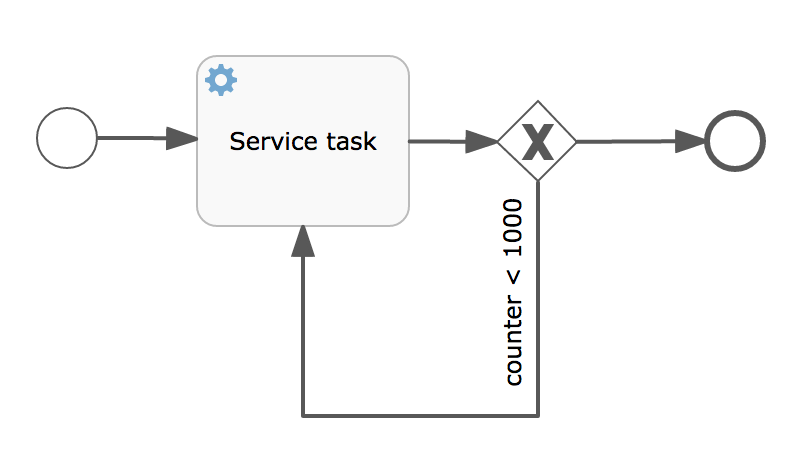

Activiti 5 uses a PVM (Process Virtual Machine) intermediate layer between the core engine and BPMN model. Activiti 6 core engine now directly works with the BPMN model. All classes in the org.activiti.engine.impl.pvm package (and subpackages) have been removed since they are no longer needed. This results in reduced complexity and an increase in performance. This also makes it possible to do things that were not previously possible in Activiti 5.
For example:
Running the process on Activiti 5 will result in a StackOverflowError. In Activiti 6 the process will run without any issues. Check it yourself by running this test available on github. The test class also contains other tests like the inclusive gateway and concurrency after a boundary event that were failing in Activiti 5 but are now working fine.

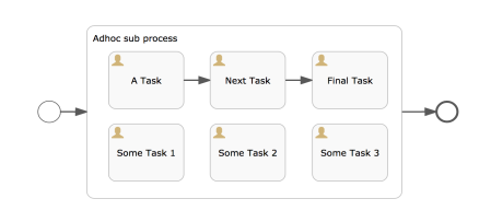

Ad-hoc sub processes provides the possibility to dynamically add sequences of work on-the-fly. As part of dynamic support introduced in the engine ad-hoc sub process allows defining tasks without a predefined sequence order. The sequence order can be determined at runtime. There could also be some tasks that need to be executed in sequence order and other tasks that are left to runtime to determine their order. The following example shows two sets of tasks, one set (A task, Next Task, and Final Task) that should be executed in a pre-defined order.
The other set is can be determined at runtime. The following code shows how to get and execute those tasks.
Execution execution = runtimeService.createExecutionQuery().activityId("adhocSubProcess").singleResult();
assertNotNull(execution);
List<FlowNode> enabledActivities = runtimeService.getEnabledActivitiesFromAdhocSubProcess(execution.getId());
assertEquals(4, enabledActivities.size());
runtimeService.executeActivityInAdhocSubProcess(execution.getId(), enabledActivities.get(0).getId());

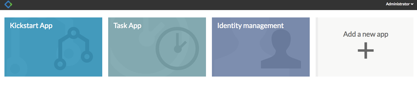

The activiti-app is a new web-based environment composed of 3 Apps: Kickstart App, Task App and Identity Management app.
- The Kickstart App includes a BPMN 2 Editor to design process models, a Form Editor to visually design forms, a decision table editor to create DMN decision tables and an App Editor to create and publish process apps bundling all the models in one single package.

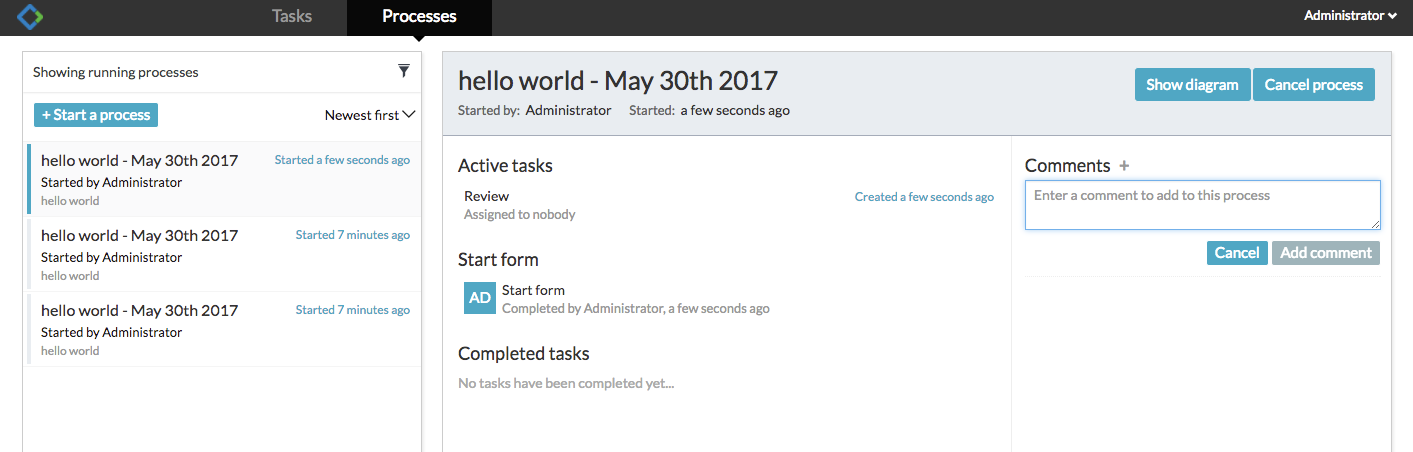

- The Task App allows you to start new processes and tasks and access tasks assigned to you from any process apps.

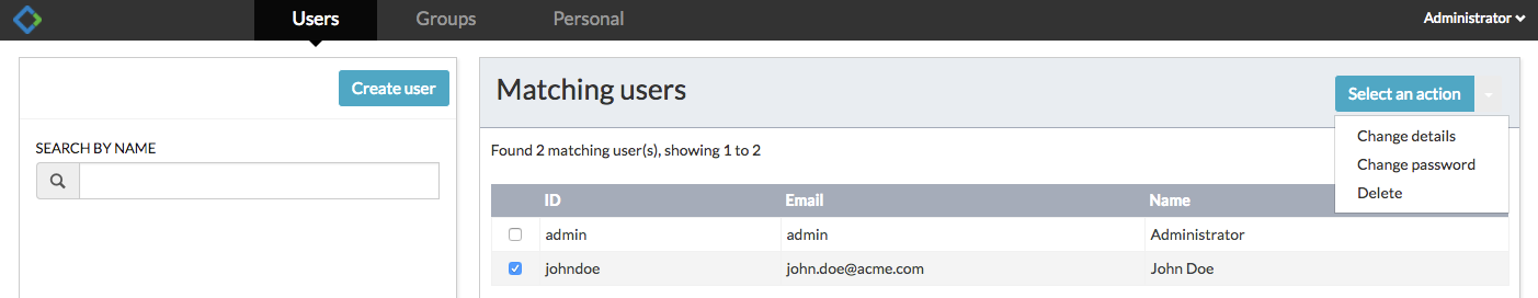

- The Identity Management app gives the admins the capability to create and manage users and groups.
The Activiti 6 app UI home page.
Activiti 6 Task App showing the process list view.
Activiti 6 Identity management app showing the user list view.

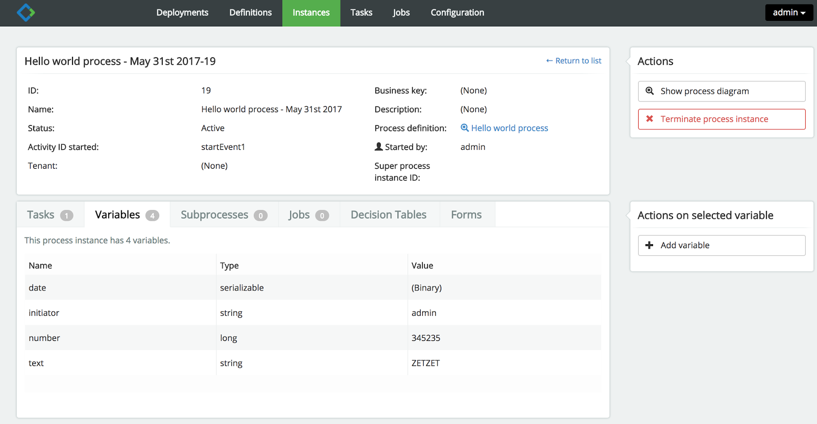

The activiti-admin app is an administration console for administrators to monitor running tasks, process instances and jobs. Admins can perform various actions such as assign/claim/delegate tasks, terminate/delete process instances, update/add/delete variables, execute/delete jobs...
Activiti 6 Admin console showing a running instance detailed view.
