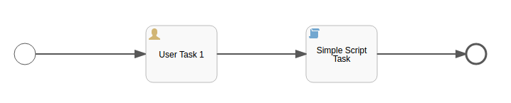

Now to test the Listener implementations create a process model looking like this:

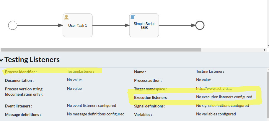

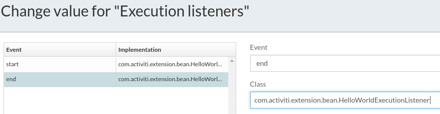

Then set up the listeners as follows, start by clicking on the canvas (not on any activity or event) so you can set the process level execution listener:
Clicking on the No execution listeners configured property brings up the following dialog:
Add the com.activiti.extension.bean.HelloWorldExecutionListener implementation for the start and end events. Then click on the User Task 1 activity:
Clicking on the No execution listeners configured property brings up the following dialog where we can set up listener for start and end event for activity User Task 1:

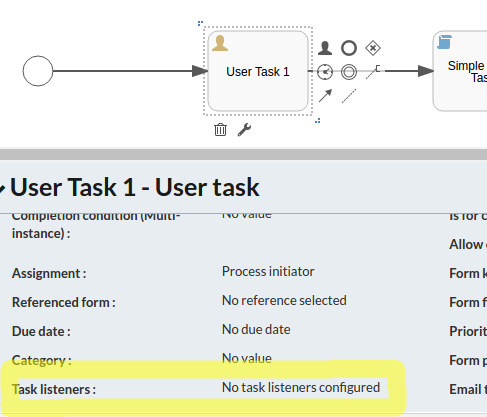

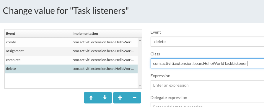

Save the execution listener configuration and then click on the task listeners property:
This bring up a dialog where we can configure task listeners for the different events:
Here we are using the com.activiti.extension.bean.HelloWorldTaskListener implementation. We can also see a new task event called delete that we can attach a task listener to, it will be invoked when the task instance is completed and deleted.

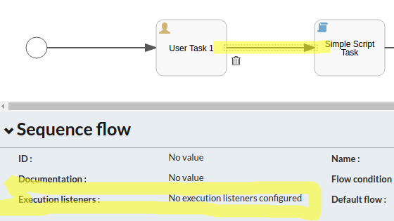

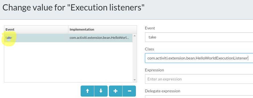

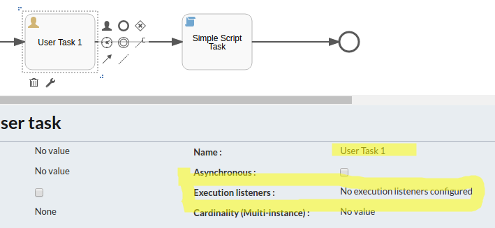

Now, for the sequence flow between the User Task 1 and the Simple Script Task set up an execution listener on the take event. First, click on the transition:

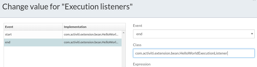

Then click on the No execution listeners configured property, which brings up the Execution Listener configuration dialog:
Use the com.activiti.extension.bean.HelloWorldExecutionListener implementation for the take event.

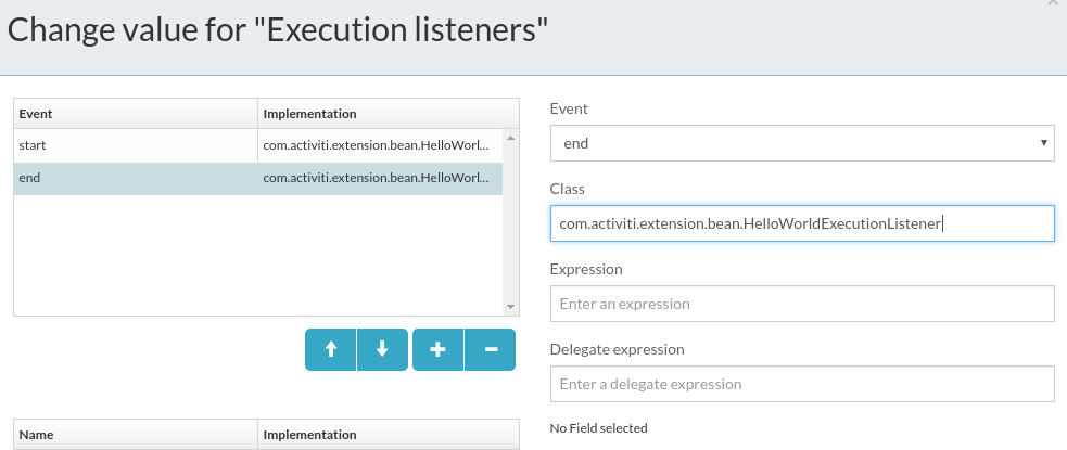

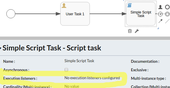

For the Simple Script Task set up execution listeners for the start and end event:
The configuration will look like this:

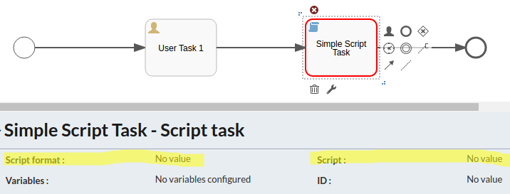

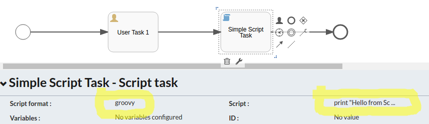

We also need to configure a script and script format for the Script task as it currently is failing validation:
Add a simple Groovy script that just prints a log message:

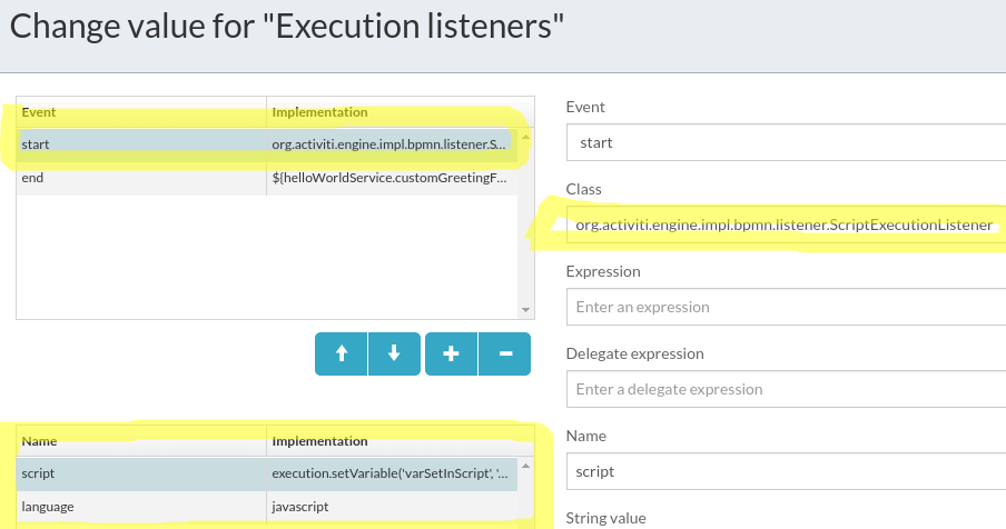

Now let’s see what process variables will be available when we get to the script task. Let’s complete the user task and we should then see the following variables when we enter the start event for the script task:
09:30:21,630 [http-nio-8080-exec-1] INFO com.activiti.extension.bean.HelloWorldExecutionListener - [Process=140005][event=start][ExecutionListener=com.activiti.extension.bean.HelloWorldExecutionListener@5b12a6e][ActivityId=scriptTask]
09:30:21,630 [http-nio-8080-exec-1] INFO com.activiti.extension.bean.HelloWorldExecutionListener - Initiator of the process has user ID = 1
09:30:21,633 [http-nio-8080-exec-1] INFO com.activiti.extension.bean.HelloWorldExecutionListener - - Process variables:
09:30:21,633 [http-nio-8080-exec-1] INFO com.activiti.extension.bean.HelloWorldExecutionListener - [greeting1Proc = Hello World!]
09:30:21,633 [http-nio-8080-exec-1] INFO com.activiti.extension.bean.HelloWorldExecutionListener - [greeting1Local = Hello World Local!]
09:30:21,633 [http-nio-8080-exec-1] INFO com.activiti.extension.bean.HelloWorldExecutionListener - [greeting2Proc = Hello World!]
09:30:21,633 [http-nio-8080-exec-1] INFO com.activiti.extension.bean.HelloWorldExecutionListener - [initiator = 1]
09:30:21,633 [http-nio-8080-exec-1] INFO com.activiti.extension.bean.HelloWorldExecutionListener - [greetingTask = Hello World!]
09:30:21,633 [http-nio-8080-exec-1] INFO com.activiti.extension.bean.HelloWorldExecutionListener - [greeting2ProcLocal = Hello World Local!]
We can see that we got pretty much all variables we have set available, the only one that is not available any more is the greetingTaskLocal as it was set locally in the user task scope. The reason we can see the greetingTask variable here is that when it was set in the task scope with task.setVariable, this method will actually navigate up the scope hierarchy until it reaches a root scope and set it there, or overwrite any local variable with the same name on the way.

Note. as mentioned before, these classes need to be located in the com.activiti.extension.bean package to be picked up by Activiti bean scanning.

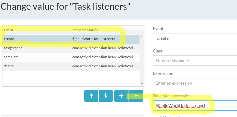

And it is used as in the following example, click on the User task and then on the task listeners property:
And the BPMN 2.0 XML for this will look like:
<userTask id="userTask1" name="User Task 1" activiti:assignee="$INITIATOR">
<extensionElements>
<activiti:executionListener event="start"
class="com.activiti.extension.bean.HelloWorldExecutionListener"/>
<activiti:executionListener event="end"
<activiti:taskListener event="create"
delegateExpression="${helloWorldTaskListener}"/>
<activiti:taskListener event="assignment"
class="com.activiti.extension.bean.HelloWorldTaskListener"/>
<activiti:taskListener event="complete"
<activiti:taskListener event="delete"
</extensionElements>
</userTask>

Implementing an Execution Listener as a Script
To set up a script execution listener we use the out-of-the-box execution listener class called org.activiti.engine.impl.bpmn.listener.ScriptExecutionListener. We set two fields for it where the first field is called language, which specifies in what scripting language the script is written in. And the second field is called script and contains the actual code.
The following is an example of how to configure a script based execution listener for the process start event:
The resulting BPMN 2.0 XML looks like this:
<extensionElements>
event="start" class="org.activiti.engine.impl.bpmn.listener.ScriptExecutionListener">
<activiti:string><![CDATA[execution.setVariable('varSetInScript', 'val1');]]></activiti:string>
</activiti:field>
<activiti:field name="language">
<activiti:string><![CDATA[javascript]]></activiti:string>
</activiti:field>
</activiti:executionListener>
event="end"
expression="${helloWorldService.customGreetingFromExecListener(execution, "Hello-end")}"/>
This script execution listener just sets a process variable called varSetInScript to val1.

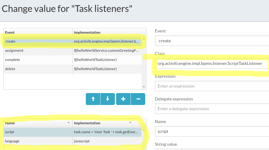

Implementing a Task Listener as a Script
To set up a script task listener we use the out-of-the-box task listener class called org.activiti.engine.impl.bpmn.listener.ScriptTaskListener. We set two fields for it where the first field is called language, which specifies in what scripting language the script is written in. And the second field is called script and contains the actual code.
The following is an example of how to configure a script based task listener for the task create event:
<extensionElements>
<activiti:executionListener event="start" delegateExpression="${helloWorldExecutionListener}"/>
<activiti:executionListener event="end" delegateExpression="${helloWorldExecutionListener}"/>
<activiti:taskListener event="create" class="org.activiti.engine.impl.bpmn.listener.ScriptTaskListener">
<activiti:string><![CDATA[task.name = 'User Task ' + task.getExecution().getVariable('varSetInScript');]]></activiti:string>
</activiti:field>
</activiti:field>
</activiti:taskListener>
<activiti:taskListener event="assignment" expression="${helloWorldService.customGreetingFromTaskListener(task, "Hello-task-assignment")}"/>
<activiti:taskListener event="complete" delegateExpression="${helloWorldTaskListener}"/>
<activiti:taskListener event="delete" delegateExpression="${helloWorldTaskListener}"/>

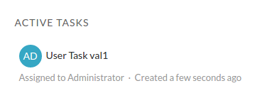

The script task listener just takes the varSetInScript variable value and then uses it as part of the task name.
Running it should give a User Task 1 with a name as follows:
