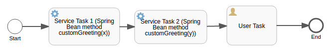

Now to test the Spring Bean method as a service task implementation create a process model looking like this:

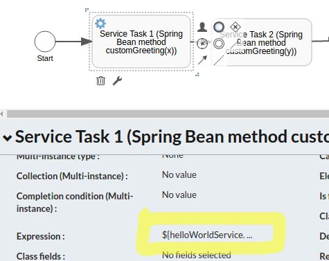

And the Service Task is connected to the Spring Bean method implementation via the Expression property:
The first service task has the following Expression:
${helloWorldService.customGreeting('Service Task 1')}
And the second task has the following Expression:
${helloWorldService.customGreeting('Service Task 2')}

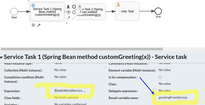

Now, to return this back to the process instance as a process variable we need to do the following property configuration for each service task:
Basically we need to specify the process variable name as the Result variable name property.
In BPMN 2.0 XML it will look like this:
