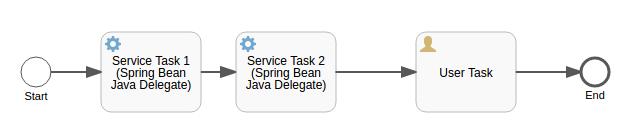

Now to test the Java Delegate implementation create a process model looking like this:

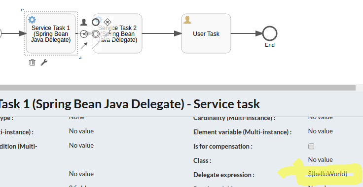

And the Service Task is connected to the Spring Bean Java Delegate implementation via the Delegate expression property:
In BPMN 2.0 XML it will look like this:
<serviceTask id="sid-7C83EB30-8E02-400B-BEEF-CAE34BFB6FFD"
name="Service Task 1 (Spring Bean Java Delegate)"
activiti:delegateExpression="${helloWorld}">
Note here that instead of using activiti:class we use activiti:delegateExpression to tell Activiti about the Spring Bean name. An activiti:delegateExpression can be used when the expression resolves to a Java object instance that implements the JavaDelegate interface.

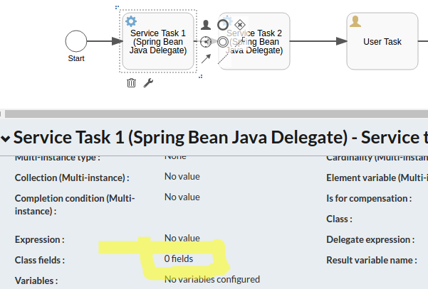

Now, let’s say you wanted to use the Spring Bean Java Delegate from multiple service tasks in your process but have the implementation behave a little bit different depending on from which service task it is invoked. Basically you want configure the implementation for each service task.

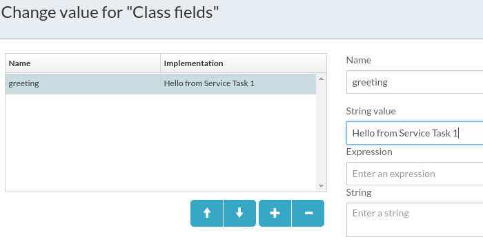

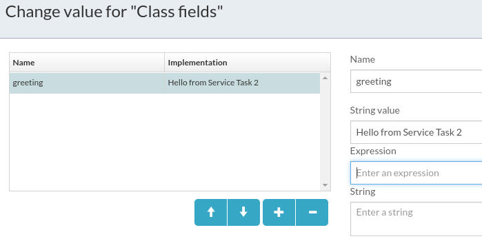

This can be done easily using Class fields and field injection. Let’s set a separate greeting for each service task. This can be done as follows, first click on Class fields for the service task:
Then set them up, for Service Task 1:
And for Service Task 2:
