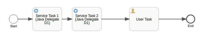

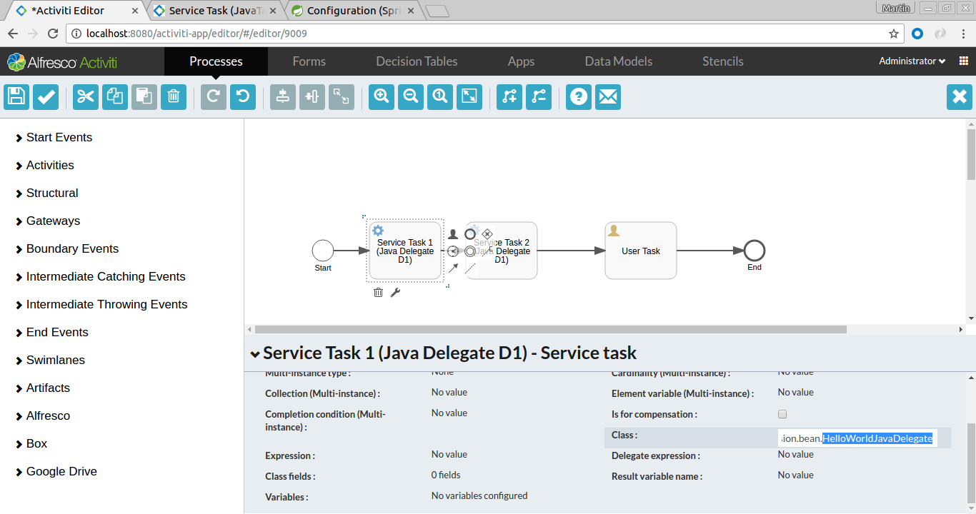

Now to test the Java Delegate implementation create a process model looking like this:
Both of these Service Tasks uses the Java Delegate that we implemented:
In BPMN 2.0 XML it will look like this:

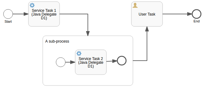

Now, what happens if we move one of the Service tasks into a sub-process:
This now produces the following log:

If you have a normal sub-process like in our example above with <subProcess id="subProcess1", it is modelled as a part of the parent process (in the same BPMN and as a child of the XML element).
If the sub-process you want to call is subject to change, independent of the parent-process, you can use a <callActivity id="someProcessId". This sub-process is called an external process (not part of the parent BPMN, but lives in it's own BPMN). This allows you to redeploy the child-process without the need to alter the parent-process.
A normal sub-process is treated as a direct child of the process-instance, so you can access the parent's process variables from within the sub-process, as you have seen above. On the contrary, a call-activity does not have access to the parent variables and is a "process instance" itself. You can expose variables from the parent-process to the call-activity by using the in/out declarations.

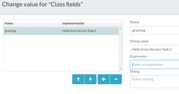

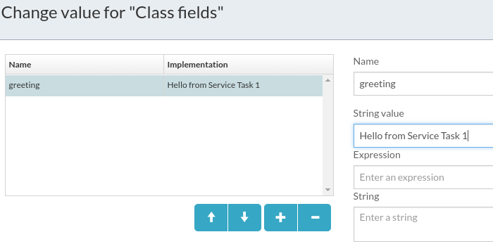

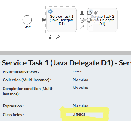

Now, let’s say you wanted to use the Java Delegate from multiple service tasks in your process but have the implementation behave a little bit different depending on from which service task it is invoked. Basically you want configure the implementation for each service task.
This can be done easily using Class fields and field injection. Let’s set a separate greeting for each service task. This can be done as follows, first click on Class fields for the service task:
Then set them up, for Service Task 1:
And for Service Task 2:

The field value is injected through a public setter method on your Java Delegate class, following the Java Bean naming conventions (e.g. field <activiti:field name="greeting"> has setter setGreeting(…)).
