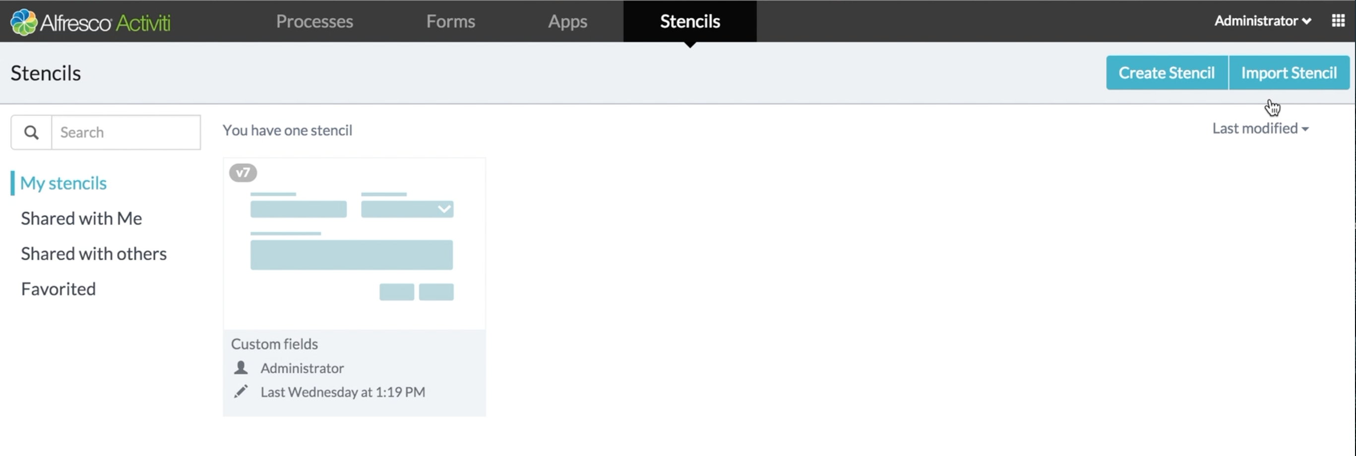

Not surprisingly, you’re going to have to do all this from the Stencils page in App Designer.
Click Create Stencil to get started, and enter a name for the stencil and choose the type of stencil. I don’t need to tell you to pick Form editor, do I?

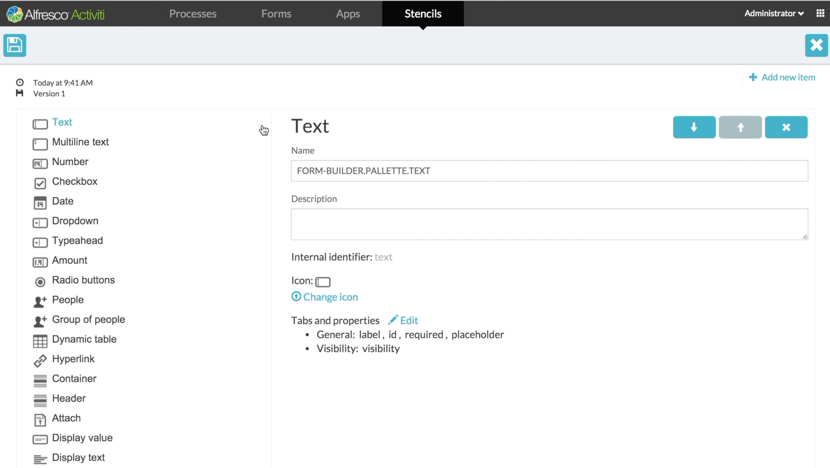

You then get taken to the stencil’s detail page. Just click the Stencil Editor button to be able to actually modify the new stencil (which starts with the default set of form controls already there).
With any of the existing controls, you can rename them, hide them, change their icon and so on. However, we’re interested in create a new control, so click the Add new item link.

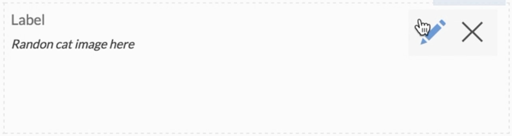

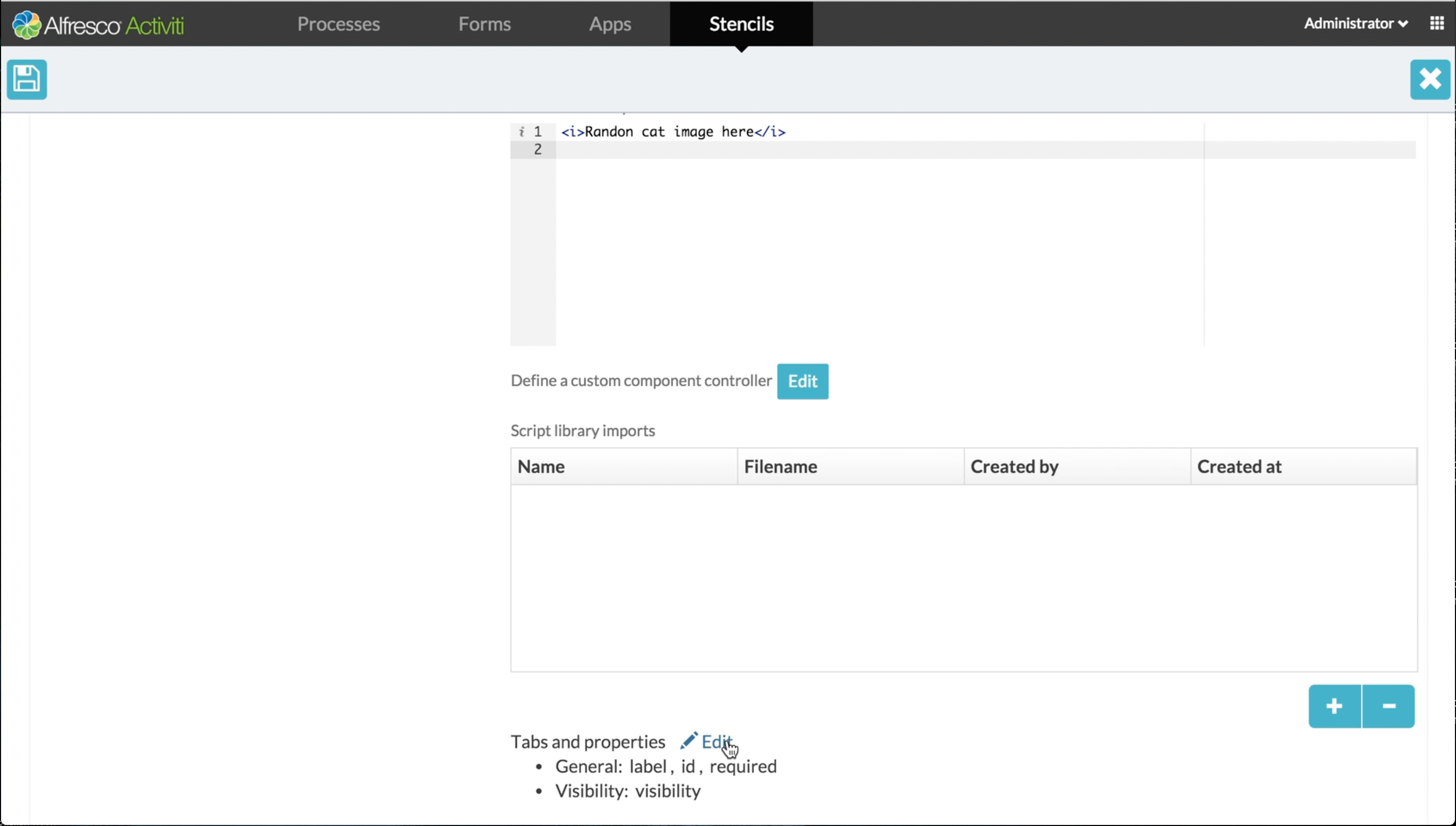

We can then give the HTML and JavaScript that should be used to represent the control at design time in the form editor. Again, you can copy and paste the text below:
<i>Random cat image here</i>
Now to define the custom configuration properties for width and height. Click the Edit link next to Tabs and properties.
In the Edit stencil properties dialog, click the Add new tab link and give the new tab the name ‘Size’. This means when we drag the new control onto a form in the form editor, clicking to configure the field will now also show a tab for size.

You should now see your cats image control in the left-hand list of field types. Drag and drop the field onto the form.
The design time view of your custom control is displayed as the field placeholder.

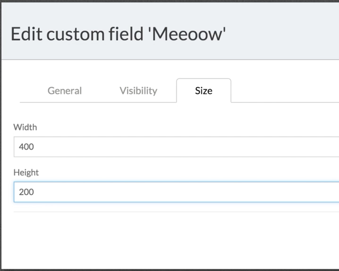

Bring up the configuration dialog for this field by clicking the edit icon.
You will see the standard configuration tabs as well as the new one you added. Click on the Size tab and you’ll see the width and height properties. Fill in some values for these. When this form is displayed as part of a process, these values will be passed to the image service to request a cat image of that specific size. In another form you might use different values to get a different size image.

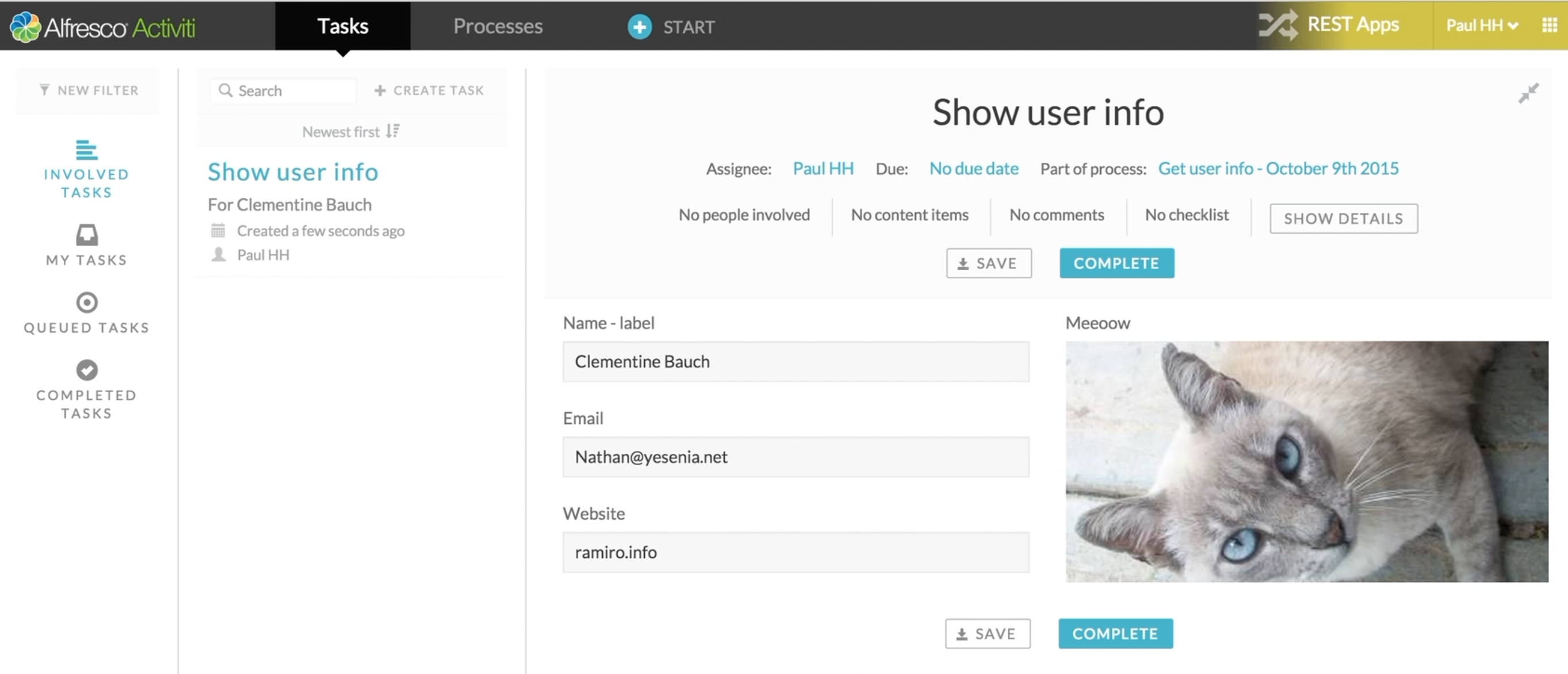

Finally, save the form and process, re-publish the process app that includes it and start the process. If everything has gone to plan and technology is playing nice with you, you should see something like the screen below.
