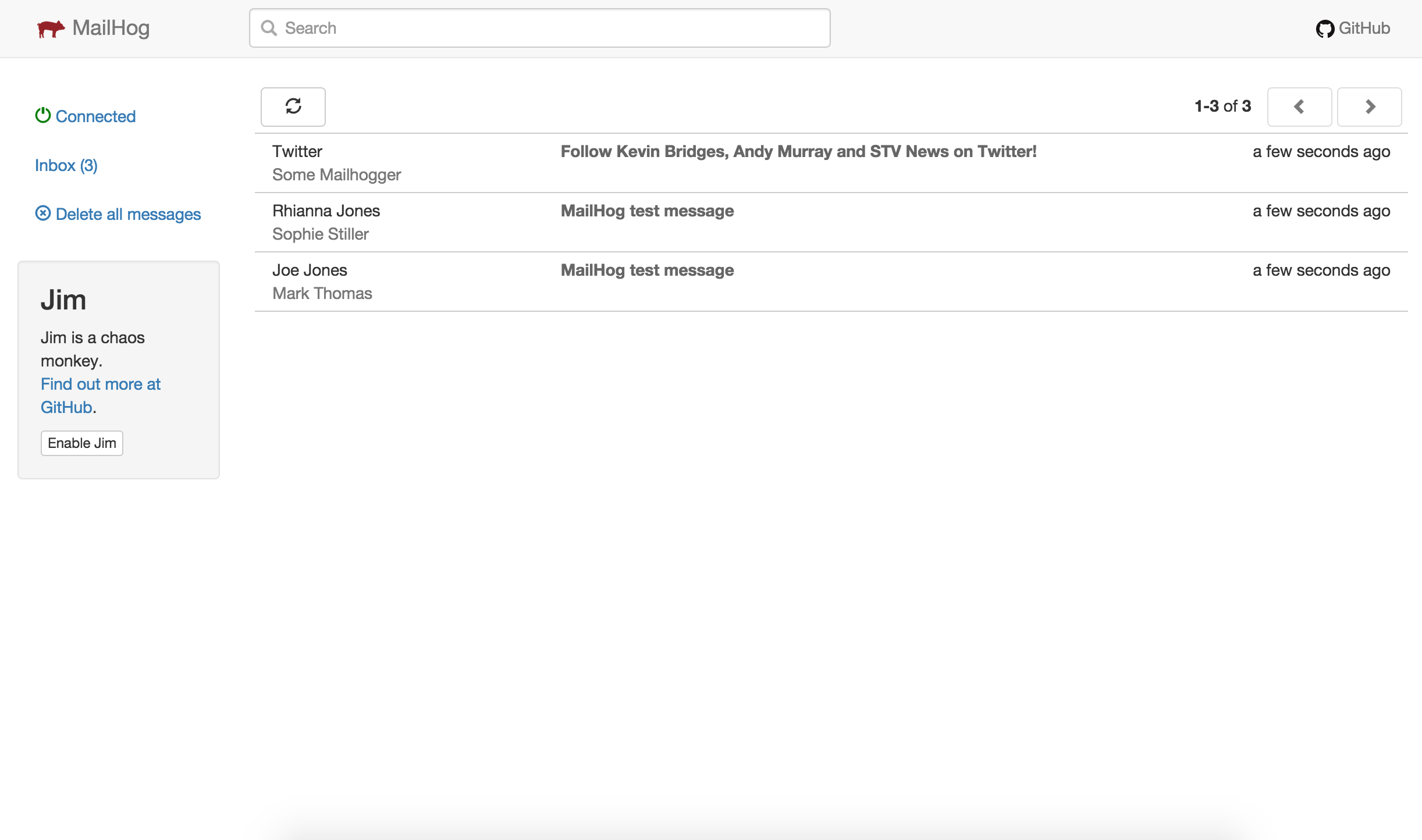

On the other hand, as part of your users tests, you may be interested in knowing and analyzing what emails generated by your Alfresco instance. In this case you could still use previous options. Both are indeed able to store emails instead of swallowing them, postfix by not linking the mbox storage to /dev/null, and DevNull SMTP server by using the "-s /some/path/" option. However storing emails on the filesystem is not really handy if you want to check their content and the way it renders (for instance).
If emails is a matter of interest then you can use other products like mailhog or mailtrap.io. Both offer an SMTP server that stores emails for you instead of sending it to the outside world, but they also offer a neat way to visualize them, just like a webmail would do.
Mailtrap.io is a service that also offer advanced features like POP3 (so you can see emails in "real-life" clients), SPAM score testing, content analysis and for subscription based users, collaboration features.

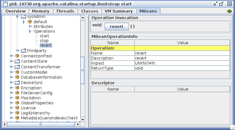

Do it wisely! An administrator should ALWAYS prefer using the "Revert" operations available through the JMX interface!
The "revert()" method is available using jconsole, in the Mbean tab, within the appropriate section:
"revert()" may revert more properties than just the one you target. If unsure how to get rid of a single property, please contact alfresco support.
